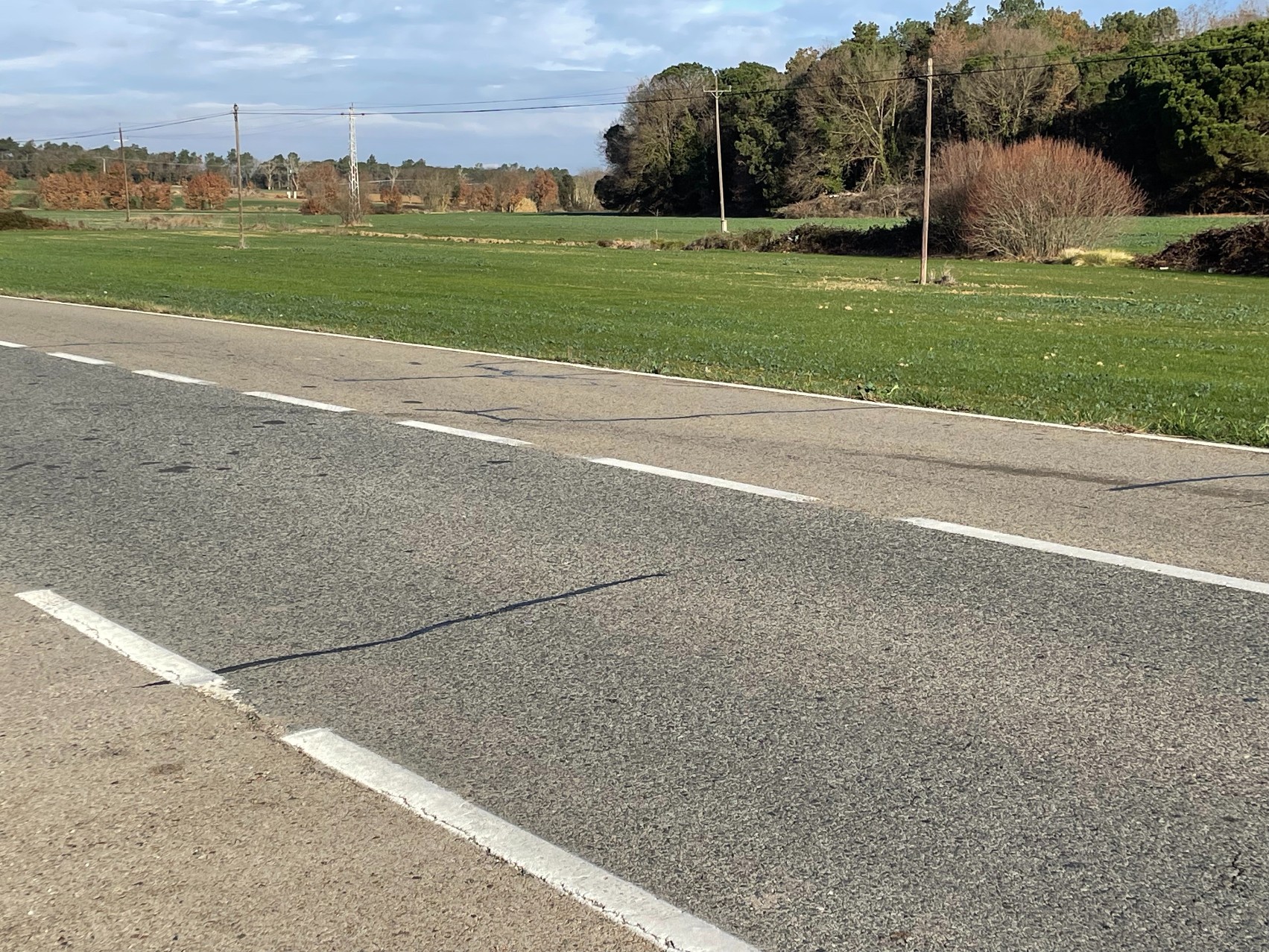

I showed a picture of the road we tested on. It’s not silky smooth. Cracks every 10-20m. It’s much rougher than UAE. As rough as most triathlons I have done.

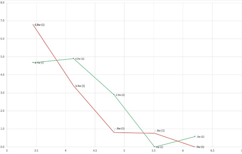

Here are the two closest riders to your weight. Although they are 9 and 3kg less than you.
At 5 bar one is giving up 2 watts, the other 1 watt. Not much, but this grows as weight goes up. One guy is 68kg the other 74kg
At 65PSI (4.5 bar), they would be giving up 4 and 2 watts.
X axis is pressure in bar. Y is watts lost compared to “optimal”
28mm 5000TT tires.
