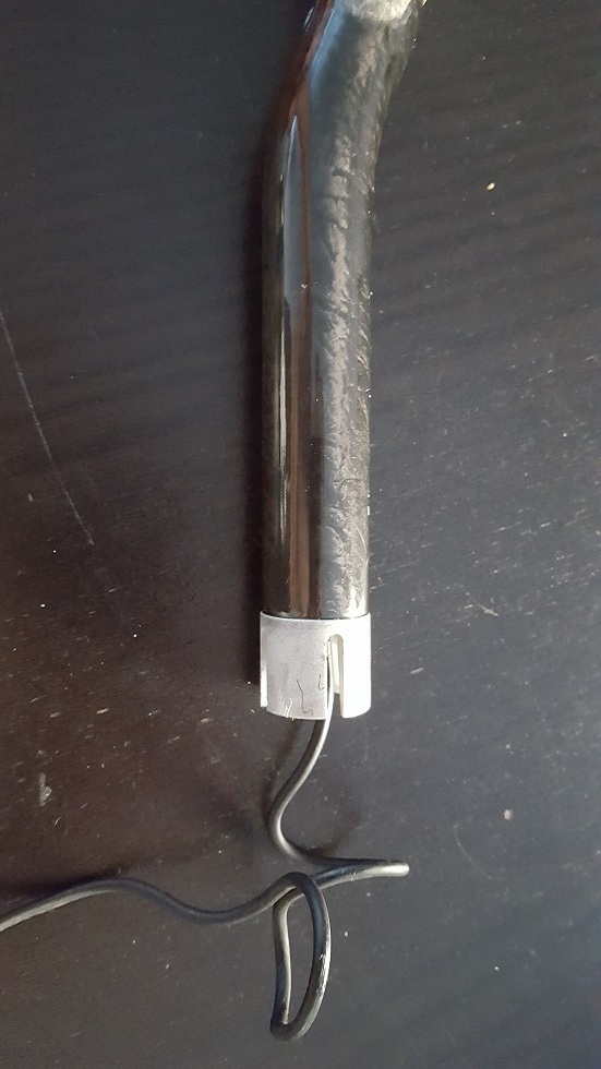

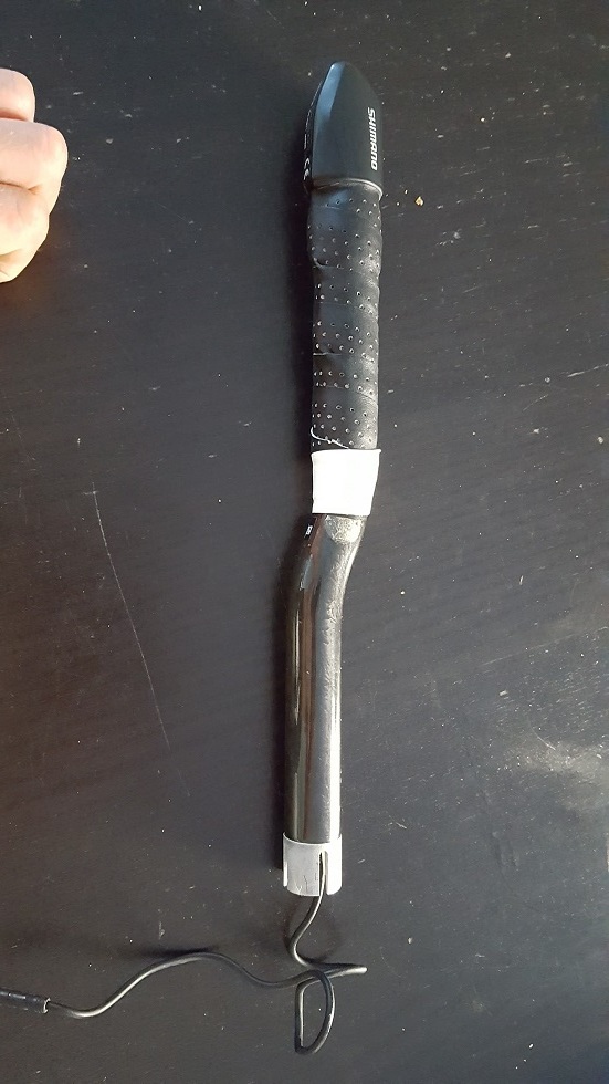

Hi,
I ordered some others extensions, which fit. But actually I got no idea how to remove the mountings inner parts. You can see the silver part which is left in the old extensions. Any ideas how to remove or how to fix the new extensions in Visions bar?
Thanks,
Peter
