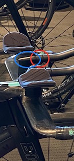

I currently have a Bianchi Aquila which has the integrated base bar made by Vision which uses the MAS style extensions. I had a bad elbow injury recently and need a more angled extension. It only came with the standard S-bend extensions and unfortunately the only other MAS compatible extensions are J-bend which I don’t think will be enough (and almost impossible to find to buy in any case) and because of the clamp style attachment of the extension I can’t use any after market ergonomic extensions. I have tried to email Vision a number of times and have not had any response so am hoping someone on here may be able to help. Do you know whether there are any of the other Vision extension setups (ie replace the bit circled in blue, item 3 - so would probably need to be the same size risers and bolt spacing) that would work with my base bar such as the TFA one which you can change the angle on (this would be the preference). Alternatively how safe would it be to get the MAS clamp (the bit in the red circle, item 6) welded to a different aero extension (by a professional) so that it could be used?
The Vision spacers on the Aquila bar, like the Cannondale Superslice are a little different from the longer spacers that you get on the Vision Trimax which would give you the adjustability that you’re after (and the ability to use a round pole). I wouldn’t get the clamp removed and bonded back on - the simplest and cheapest thing to do would be to try and find the official J bend extensions if you can, and then add an angled wedge under the arm rest to create a more comfortable angle there, we (AeroCoach) also do an integrated extension (Ascalon) which is compatible but which may/may not be out of your price range.
I’d start by trying to get the J bend extensions as that would hopefully fix it a lot easier - you might be able to find those J bends as part of a set of Vision clip on bars which you could then remove?

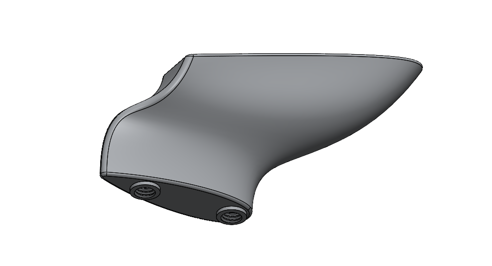

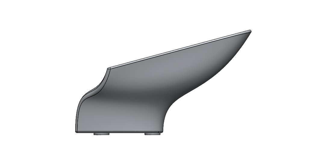

With the lack of options to purchase the MAS extensions (at least in the UK) I’m designing some custom aero extensions to go on my 4D Flat M.A.S. Bars. I’m planning on 3D Printing some aluminium adapters to mount the extensions onto the bars. I’ve taken a 3D scan of the mounting area of the bars and by my measurements I’ve got 1inch (25.4mm) spacing on the holes, with M6 bolts and 8mm location lugs.
Firstly, is that correct?
Secondly, the area where the extensions mount onto the carbon bars isn’t flat, but how critical is it to mimic the curvature that surface, or will a flat surface distribute the loading onto the bars sufficiently & safely?
Thanks
