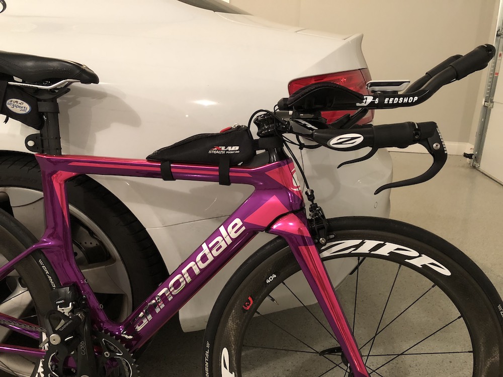

We paid someone to wrap my wife’s bike a few years ago. It wasn’t cheap. It looks great. It has held up well but not as durable as paint (nicks happen more easily…maybe show up more because of the chromed vinyl we used). If we had to do over again we would have had it painted. The more crazy the design and the tight or complex the frame corners/curves the more difficult it is to keep the edges in those area smooth and stuck down. This is the only picture I have on this computer.
