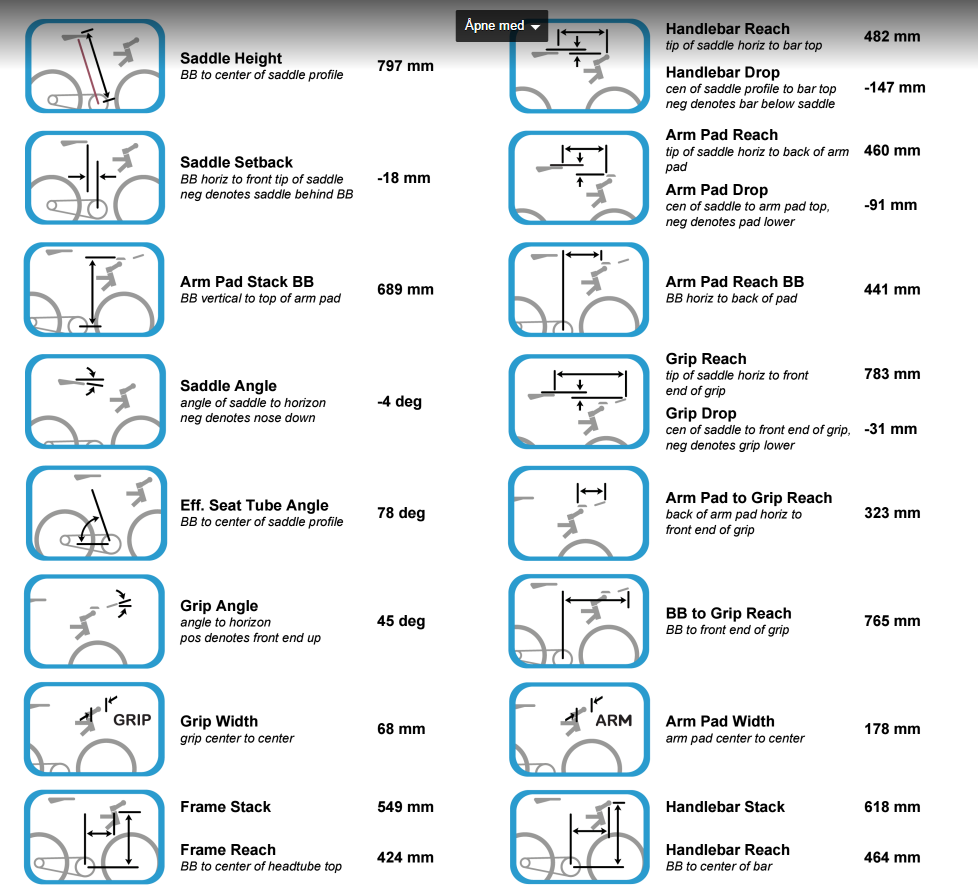

So I’ve been back and forth trying to find a good position on my P3 for some time now and got a retul fit a couple of weeks back. Ended up changing the orginial 90 stem for a 60 stem but the retul fitter still says that the reach is a little bit long… I did ask a similar question earlier and I got feedback that my posture is terrible and I’m not rotating my hips… Others have said I should lower the cockpit which I also tried - it did feel quite good but my hips felt kinda squeezed, like I was unable to generate power. The first thing the retul fitter did was actually raising the 3T bar again.
I just can’t understand what seems to be the issue… Based on the info I got from the fitter I started wondering about changing cockpit or perhaps changing bike as I’ve read that Cervelo’s can be quite long… So, using my retul fit and checking other bikes I’m quite baffled… I might be totally wrong here, but wouldn’t my Pad Y & X be something like 441 and 689mm - and as I should have a even shorter reach (according to my fitter), close to no bikes fit? I’ve been looking into Scott Plasma, Cervelo P5 (54 size), Canyon Speedmax and so on… I must be completely off here? I talked with canyon and they suggested a large frame which from the specifications provided looks like it has MORE reach than the P3.

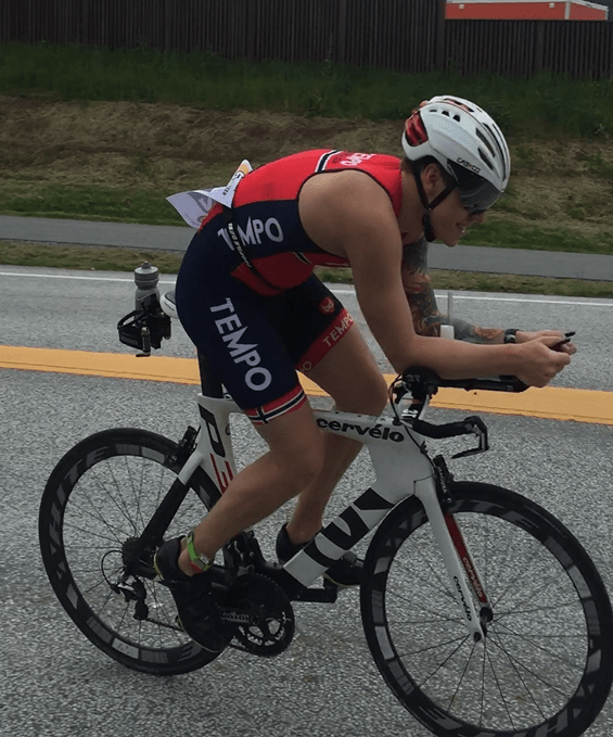

Attached retul report and pic of my last race a couple of weeks ago with the retul fit position. I can do a better photo/video if it’s no good.

The angle at which that picture was taken is far from ideal so it’s hard to tell from that perspective but…
you need more pad reach and less pad stack. You’re riding high and cramped, at least from that bad angle.
agreed pretty much, more reach and a better picture for sure.
Really looks like you are fitted as if that P3 was a road bike… everything just looks shifted rearwards.
Retul is nothing but a tool, what you really are paying for is the fitters knowledge and ability to translate that to the best fit for YOU. I’m not knocking the fitter, but looking at the picture and the recommendations you got, it makes me wonder…
Definitely need more reach, there is no way that your reach is still too long, and maybe lower the cockpit some, its kind of hard to tell from the pic but I wouldn’t be going to that fitter anymore.

are you set up on your bike according to the retul report? i ask because people here are complaining about your scrunched cockpit, but the report says you should have an “armpad reach” of 460mm, and they measure to the back of the pad. that’s not consistent with a scrunched cockpit. that’s about 500mm to pad-center.
now, it could LOOK scrunched because your pads are so high. just, i’m wondering if the bike is set up as per the report.
Thanks for all the replies guys.
Yeah, the photo is me racing in the position exactly as per the retul report. The fitter did advise me to raise the seat by 0,5cm but I needed spacers for the 3T aura bar which I received yesterday. So yesterday I raised the seat 5mm and added the 10mm spacers. Here’s a much better photo just now.

that’s the danger of one shot from a bad angle from a race… new picture looks a lot different. (and better)

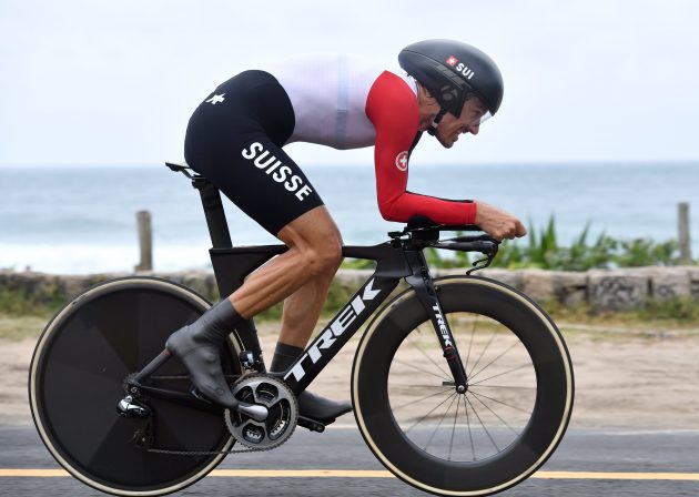

It’s great that you’re willing to adapt your fit. Work incrementally towards something like the Fabian Cancellara position. It’s very possible to create an aerodynamic and comfortable fit.

…and when the retul numbers don’t match reality for the actual frame stack/reach(compare database on this site or cervelo’s page to that listed in retul output), how much faith do you put into the rest of the numbers being accurate?
position is beach cruiseresque with bend mid back to reach bars. not sitting on that saddle as it is designed to be. cervelos(the one OP has) are not a long/low frame
Are you sure about your inseam? You mention 84 cm but your saddle height on the retul form is almost 80 cm heigh?? That sounds a bit off for either one of them.
