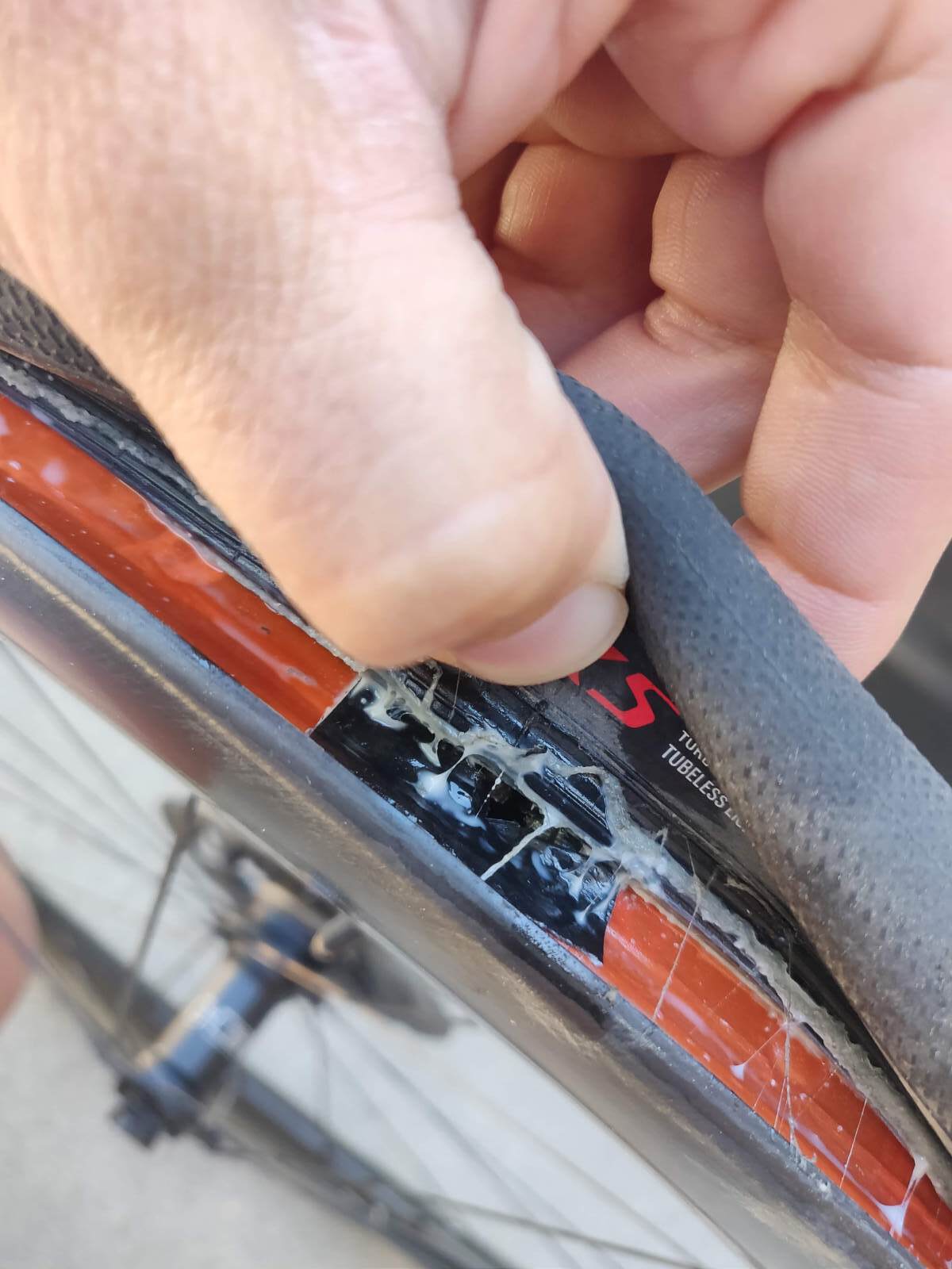

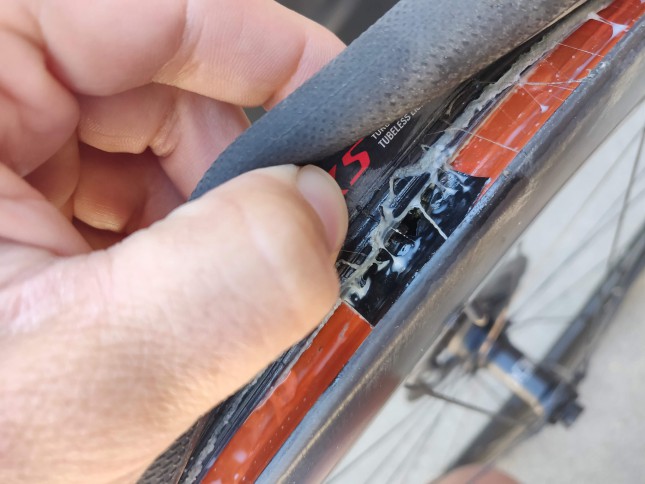

I attempted to set the V6s up tubeless with S-Works Turbo 26s. While my tubeless experience is limited to 4 other sets of wheels, the V6s were by far the most difficult wheels I’ve ever attempted to set up tubeless. After hours of frustration trying every tubeless trick in the book, I ended up taking the wheels to my LBS. In fact, I had to take them to 3 different bike shops before the last one was able to set them up! The problem seems to stem from the tire ‘seating’ area being sloped inward towards the center of the rim. Because of this, the tire bead doesn’t seat solidly and just slips back down in to the center channel. The 3rd bike shop was able to get them installed by ‘building up’ the center channel with many extra layers of tape, using zip ties and a high-powered compressor. I had a back-and-forth email with HED about this with no ultimate resolution.

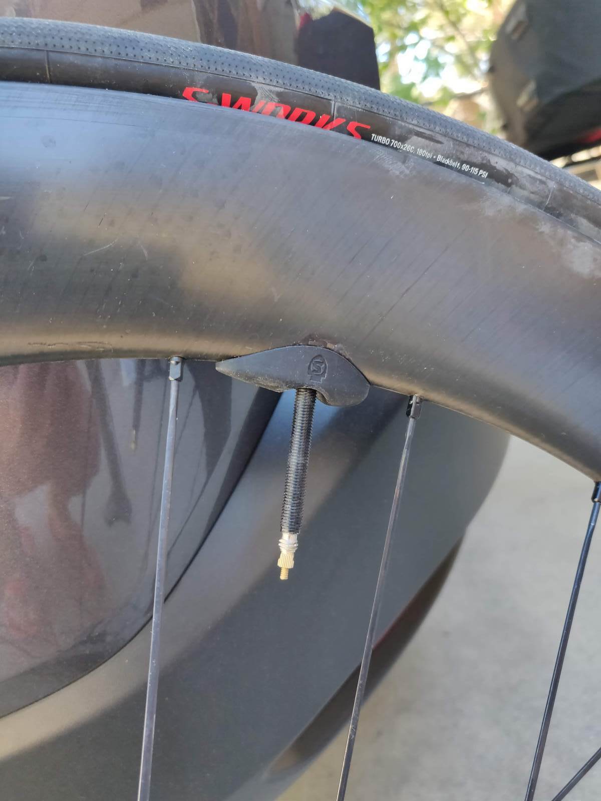

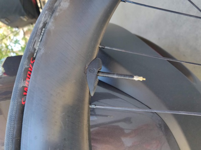

Once the tires were finally set up tubeless, everything seemed OK, the V6s offered a plush ride and excellent crosswind stability. I happily rode the wheels for over a month without issue. However, after one long day the saddle I sat down on the couch to rest with beer in hand when I hear a sudden bursting / air gushing sound. My first thought was “Holy shit. One of the tires just failed and 20 minutes ago I was descending at 50+ MPH!†No, it wasn’t the tire, the Silca tubeless valve was ‘sucked into’ the wheel:
After inspection, I thought this was a nearly-catastrophic tubeless valve failure, however, after dialogue with both HED and Silca, it turns out the issue was that the HED wheels required a special rubber adapter grommet to be inserted into the valve hole prior to insertion of the tubeless valve. Sure, you could call this user error, but the grommets were not included with my wheels and no one I have ever talked to (including multiple bike shops) have ever heard of having to use a special grommet to set wheels up tubeless. Plus, why would HED design a wheel with a oversized & non-standard valve hole to begin with? Anyway, HED sent me the grommets at no cost. On to more concerning problems.
