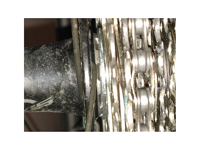

Can’t see the attachment, but if you have a spacer with an 8 speed cassette, it’s probably an 11 speed compatible freehub. There was no change on freehub width from 8-10; 9 speed cassette was the same width as 8, and 10 speed cassette was actually narrower so they used the same hub and a 1mm spacer. Not until they went to 11 did the freehub get wider. 8 and 9 speed cassettes work on an 11 speed freehub with a 1.8mm spacer. 10 speed works on an 11 speed freehub with 2.8mm of spacing (usually a combination of 1 and 1.8mm). I wouldn’t be surprised if, for inventory simplification, Specialized didn’t build all its 8/9/10 speed road bikes with 11 speed compatible freehub wheels anymore.
So it may be possible to just switch the cassette from 8 to 11 (or 10). That makes sense because when I look up the wheels on specializeds site, it’s a sealed, 3 pawl ratchet, 11 speed hub. If that’s the case I can’t wait to order the parts and get this started! The wheels are Axis 4.0 SCS QR.
