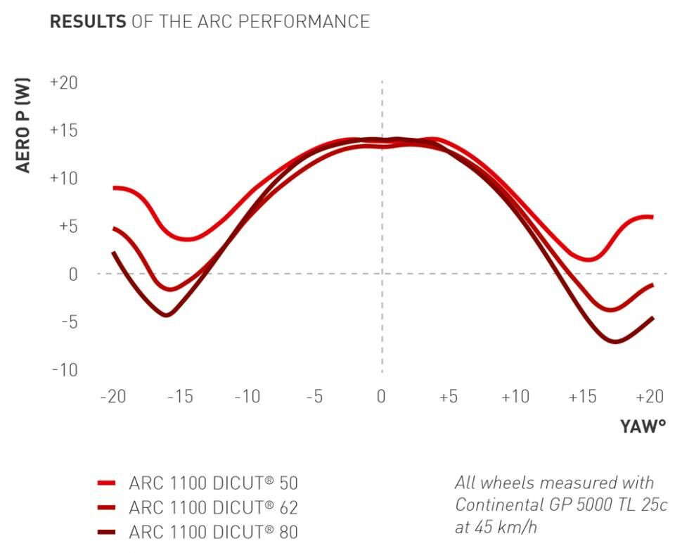

You see that at lower yaw the 62 outperforms the 80.
It’s only at greater than 10deg yaw that the 80 starts to be advantageous

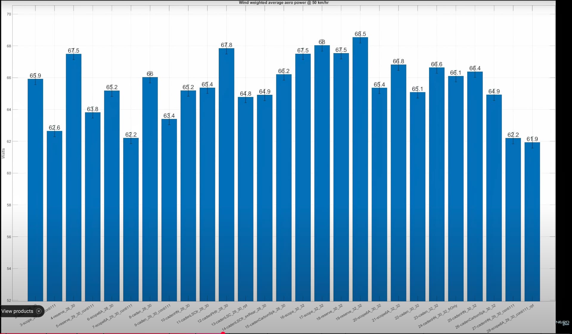

I don’t think you give up a ton with the 111. Per BRR, the 29mm 111 rolls 2.5 watts slower at 72psi than a 30mm Archetype and 2.2 watts slower than a 28mm GP5000 TT at 29kph.
But if you look at the Nero wheel test data the tire is consistently about 2.5 watts faster in aero compared to a 28mm front, at least at 50kph.
At the expense of a few grams you get better wet grip on the 111 too.
I did dozens of tests last summer with the 111 and it was never faster than then TT. It lost like 10 times to 0.
I also compared it to the 5000s and showed almost identical RR
We took it to Silverstone and we saw the aero savings were real but it was always at > 12deg yaw, which I never saw in the road tests.
Recent road Archetype tests show it is a bit faster than the TT. Silverstone aero tests showed the RR outweighs the extremely marginal aero penalty over the 28 TT. Puncture resistance is the big question mark at this point
