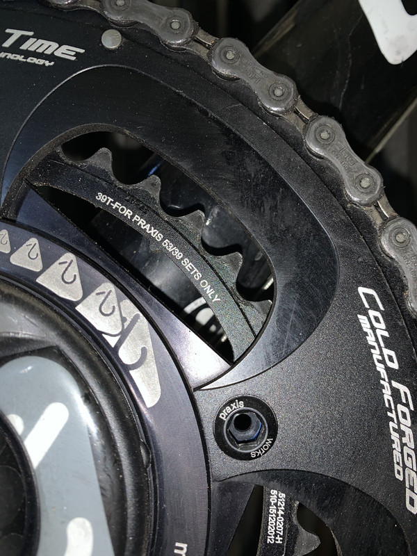

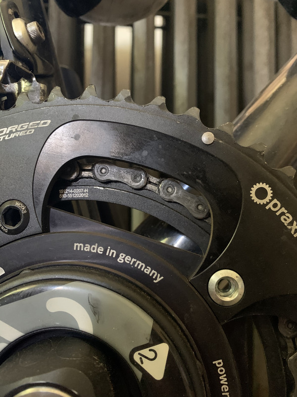

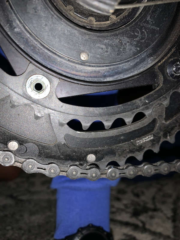

Bike is shifting great, except that the chain drops off the inner ring when I am standing on a really steep climb and put down anything north of 350 watts. The FD is correctly adjusted… I bought the rings used a few years ago from another STer, so I don’t truly know know many miles are on the rings. Do they look like they need to be replaced?
