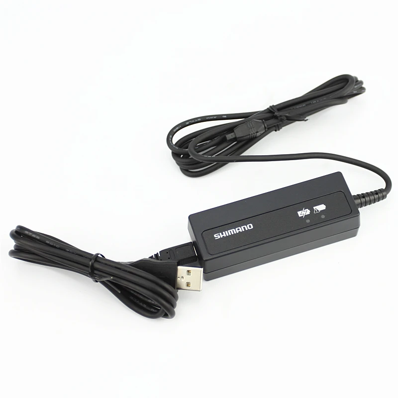

The SM-BCR2 doubles as both a battery charger and PC interface, correct?
I have a battery, the SM-BCR2, two JC41’s, the five port and some wires laying around somewhere from an old install on a previous bike. So I think I just need shifters and derailleurs.
Yes it does but only on a limited basis as that isn’t it’s primary function. Not to the level that the PCE1 or Bluetooth will allow you to do and not as reliably as Slowman mentioned in an recent article write-up about Syncro shift. Maybe you can get away with just using the BCR2 only but if something really goes wrong you will need to use a PCE1 (in case of DN110 battery accidental bricking you’ve got to reset it with a PCE1 if the typical troubleshooting tricks don’t work).
I’m looking to eventually get one myself but so far but waiting for a good deal on one. But yeah I do agree most likely you can get away with just using that. But I like to have all the tools on hand to do work myself for the convenience and not have to rely on the LBS.
I am pretty sure that the PC-based E-TUBE software behaves indentically whether it is connected through the dual function BCR2 charger or the legacy PCE1 interface. Further, I think it is the BT-based mobile app that has some limited capabilities versus the PC-based E-TUBE software.
Pretty sure the BCR2 doesn’t allow you do to the synchro shift, you need the BT-DN110 battery…I think.
The BCR2 is the charger for the BT-DN110 and doubles as the PC adapter.
https://ae01.alicdn.com/kf/HTB1VUJQpQOWBuNjSsppq6xPgpXa9/Shimano-Di2-Battery-Charger-SM-BCR2-for-Battery-SM-BTR2-BT-DN110.jpg
No need for the PCE1 or wireless unit to setup synchro shifting. You can do it all with the BCR2 and PC software.
I hear that the PCE1 will let you do more detailed diagnostics if you brick your system. One of those questions if you want to spend $140 and figure things out on your own or take it to the shop when things go south.
Sorry, meant the old battery, btr-2.
