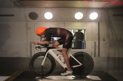

Tested there about a month ago. Had a great time and learned a lot. Everyone was very helpful. Here is my final and fastest run.
http://i269.photobucket.com/albums/jj79/Tri509/01268411-d2b2-4db6-8727-66a6bf0421f7_zpsce948daa.jpg
Congrats!
Wow, I didn’t even notice the age of your original post. :wink:
