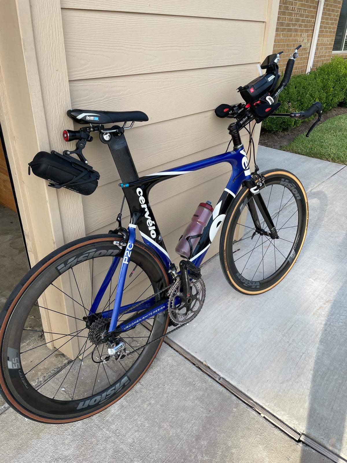

I was able to put my old Vision Merton SL55 with Conti 5000 28s on my old P2C. The clearance is very small, but it works, is smoother and faster. The difference is 17.7mph on the old Zip 404s with Conti 5000s 23cm versus 18.8mph on the same course and similar weather at 117 ave watts for both races. (I’m 64yo and relatively new to cycling, so I don’t have a lot of power.)
The fronts are the smallest clearance and I have to be careful that I put the wheel on straight. I got longer screws for the rear adjustment and it fits fine. Of course, I also had to adjust the brakes.
I would think a setup like this will work on the P2. But if you want to spend $6k for a newer bike, then go for it.
It would be great to see your setup

I think I edited and added a pic (still getting used to new forum - which I love)

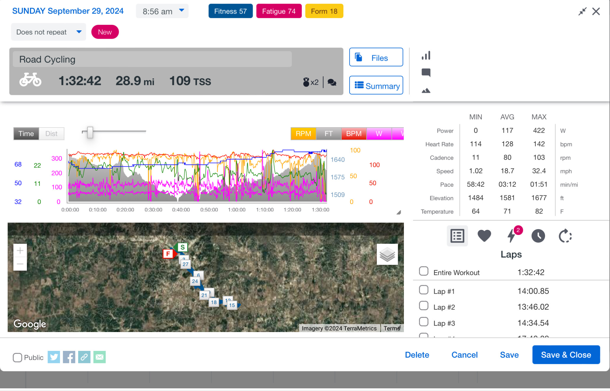

Results from race last Sunday.
End of bike section. Notice I have a smaller tool bag, non-aero helmet and third bottle. Screen shot from video

Do you think his power meter is off if he is doing 18.7 mph on 117 watts
My wahoo kickr also has my FTP around 165 and my Specialized SL6 with Rotor power meter says the same. So, while it may be off a little compared to three I have, they all say my FTP is around 165.
I don’t know enough to argue one way or the other. But that’s all I know. When I had the 23mm my speed at similar watts was around 17.5mph.

18mph at 120w is around 0.250cda. It’s fine but not great.
Is also hard to compare between different days as weather conditions play a huge role. Aside from wind the temperature and barometric pressure have a big effect on air density, which in turn directly affects speed at any given power. Luckily since you have the dates, times, and locations you can lookup weather data and calculate the air density for each ride.
Other things you need to have to compare two separate rides accurately is road surface, tire pressure, braking and turn data, elevation changes, time out of aero tuck, just to make a few.
