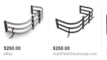

what about something like this, either prefab or DIY
(Strap everything down really good) and add a gate fence.
If I had a truck I would like the added security when removing the front wheel and bolting the front fork to the truck.
