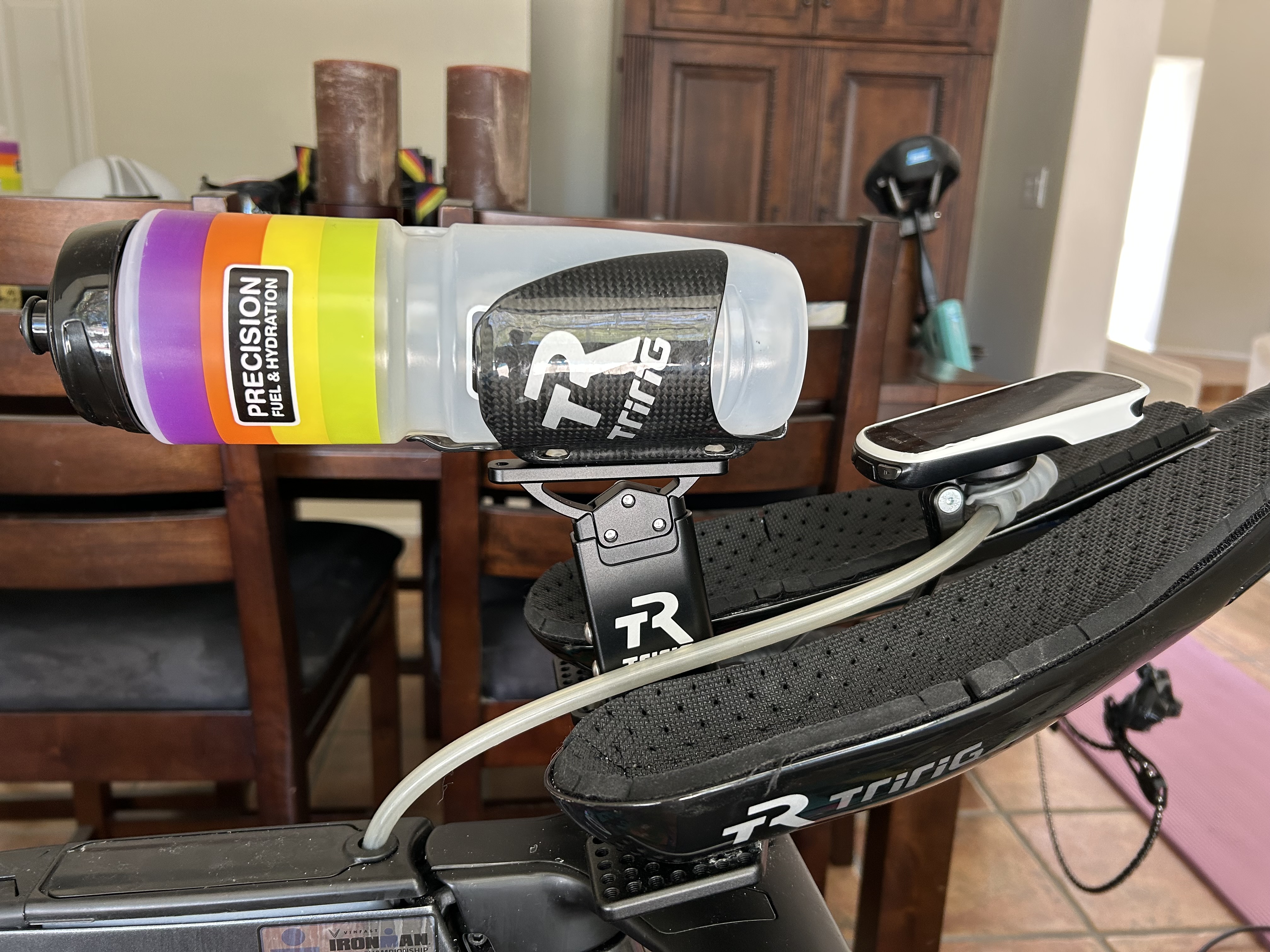

I’ve been riding the non adjustable riser since it came out and haven’t had issues with 3 bottles. Swapped to the new one and it feels sturdier if anything. Need to use a shorter bolt on that PD wedge under the front bottle but I’ve got no hesitations running this setup.
Hi Ben - I have been thinking of raising my bars….what’s that bolt you have running through the vertical post in the picture? Stability with the weight of the bottles?

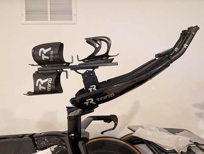

That’s the Tririg Multi Bottle BTA rail shown below.

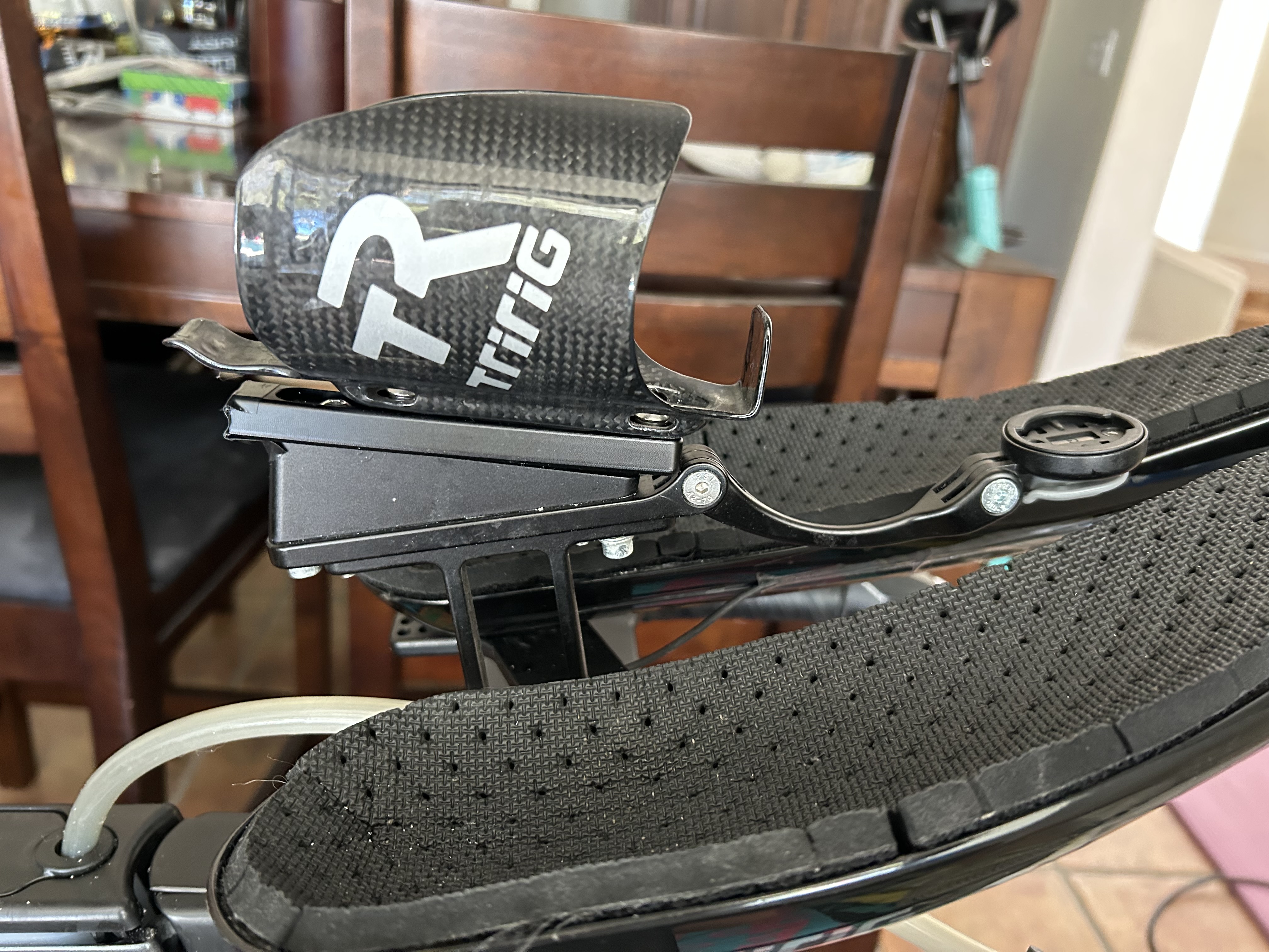

I think he means the bolt just above the base bar. It looks like a sort of ‘security’ thing to prevent the monopost from slipping down? Ben can shed his light on it. But it sure looks like that there is another sort of seatpost wedge attached to it in a upside down position to create an extra support. Might be that the monopost wasn’t designed to carry 2 or 3 bottles at that specific location.
Jeroen
Ah so that alpha one is an out of spec basebar that I was testing with that knowledge. I added a few bolts just to ensure no slippage. I don’t think the weight of bottles affects any possibility of that anyways. If anything it would be my super forward position.
