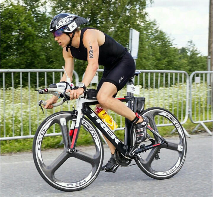

I’ve been using them for two seasons. Don’t use any other wheels anymore. Apart from the trainer naturaly. Got some decent speed, maybe 2kph more. Not a good bikehandler, and I have some problems in hard crosswinds. I’m 140-145 so that might be part of the problem. Had one race screwed up because I couldn’t stay aero due to large open fields and hard crosswinds. No problems in other races and just a few times during training. Apart from that I love the wheels. Feel fast, are fast and look awesome. And they feel more stable than regular spoled wheels so I don’t feel a need to keep trainingwheels anymore.

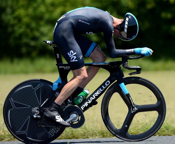

I would imagine this team knows about marginal gains?

That is a great Photo !!!

This is my experience too. I bought my set from the Classifieds here in 2011 and ride them 100% of the time. The look awesome, ride awesome, and are awesome.
