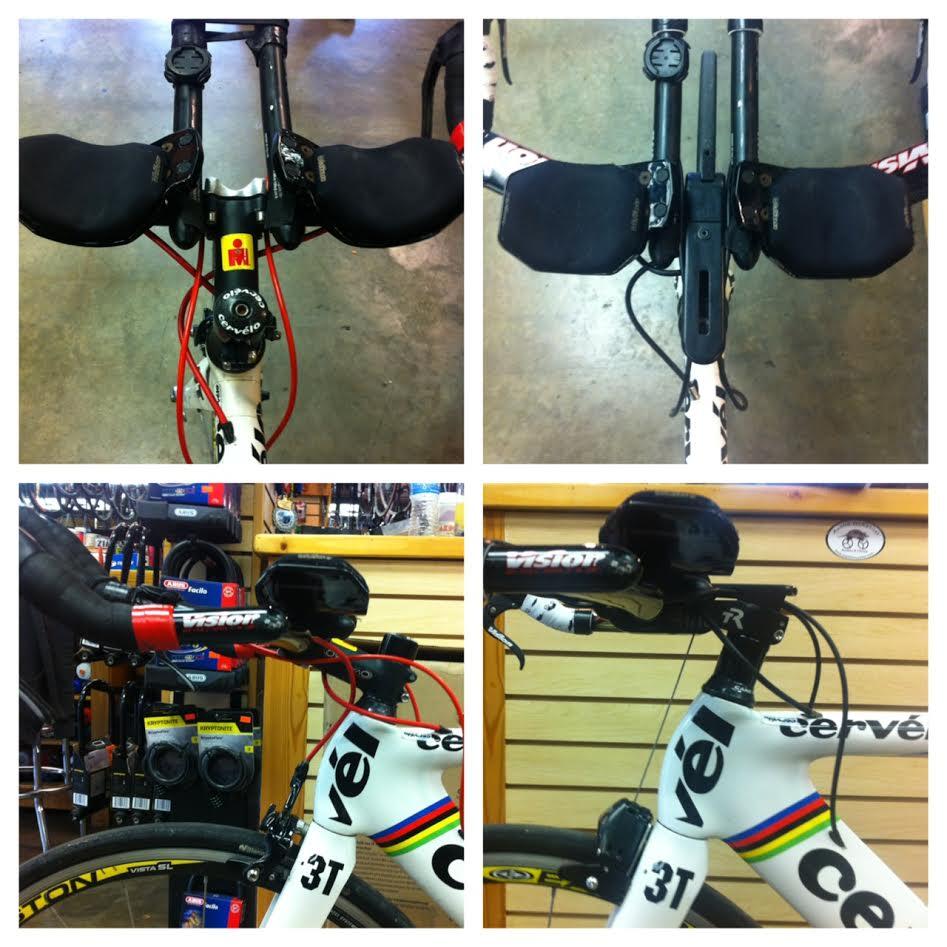

Ive put it on my wife’s bike to great effect, we did a write up on the install and setup here:
http://austintriathlonstore.blogspot.com/2013/10/aero-tune-up-turn-your-aging-tri-bike.html
The only downsides - it isn’t light, and you have to cut your steerer tube to the exact height if you want to use the cable cover, there is no going up again.
here is one of the pics:
http://1.bp.blogspot.com/-jFV2l0QDRCc/Ump8nW5dEGI/AAAAAAAABS0/s2axi4V7zYc/s1600/sigma-cover-on-side.JPG
and on her team mate’s p3, still working on the cabling:
https://pbs.twimg.com/media/BZnkrO8CIAAtNci.jpg:large
Hi Jack. Read the article already. Thanks. Can you tell me in mm the height of where the stem attaches to the tube. Mine is already cut. Also, since it’s you do you have any thoughts on a similar aero stem? Thanks.
The height of the stem where it clamps to the steerer tube is very very short, it is pretty much impossible that you steerer is too low already. You will probably have to cut it more.
You can put spacers under it like any other stem, just not above it to leave spare steerer tube.
The only stem that is at all similar I think is the Pro Missile Stem.
