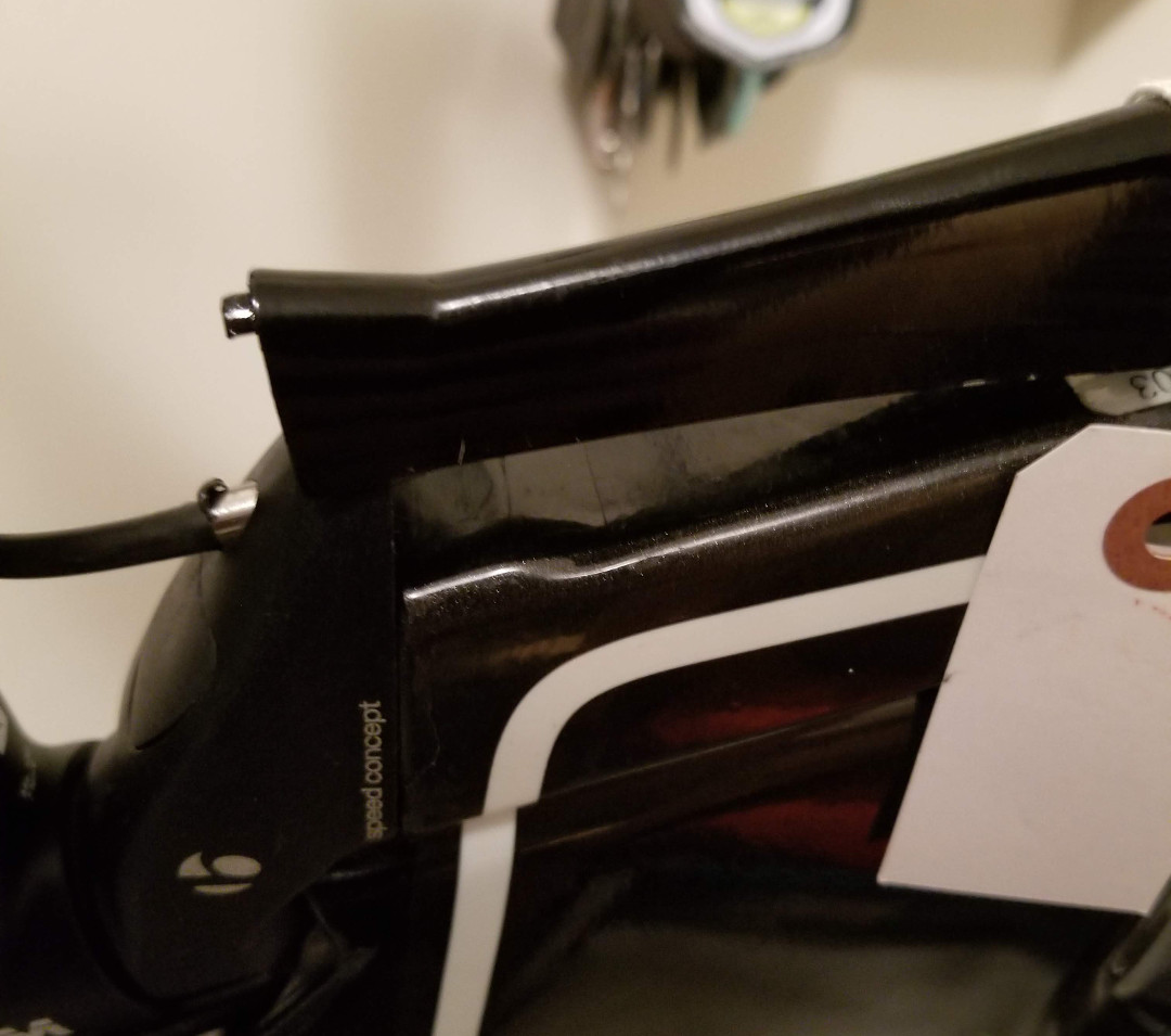

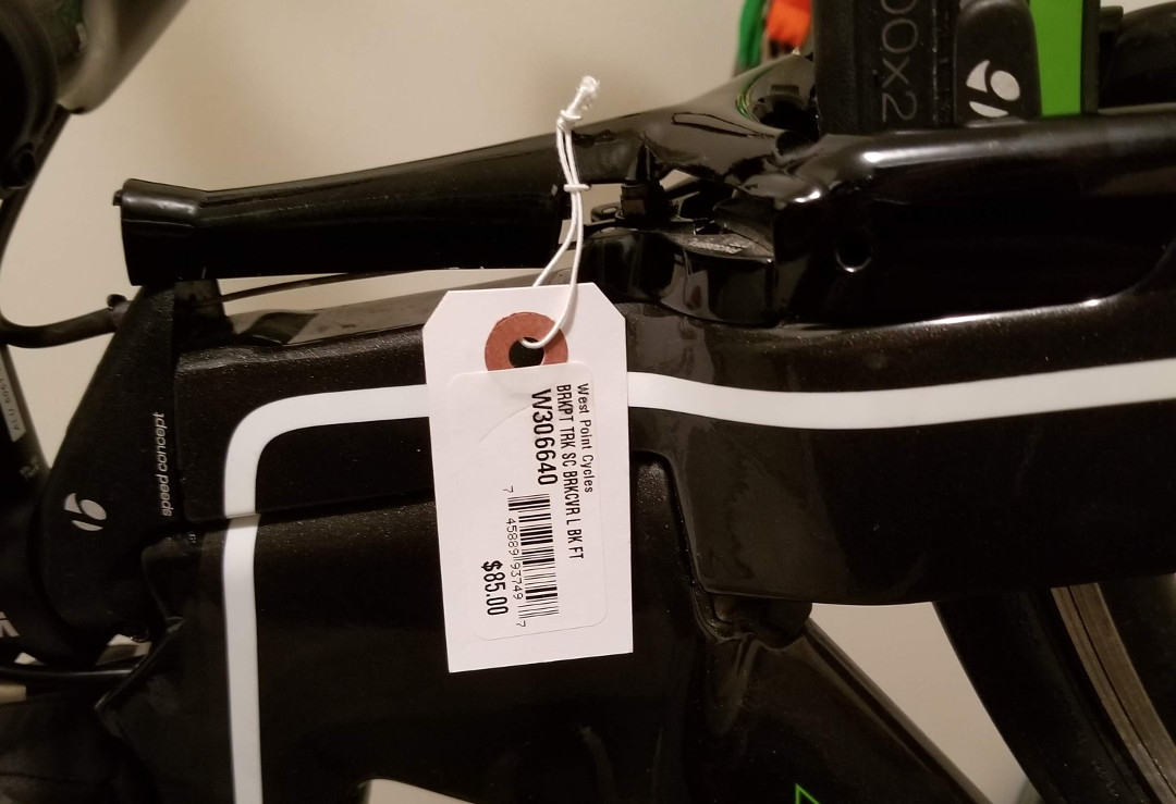

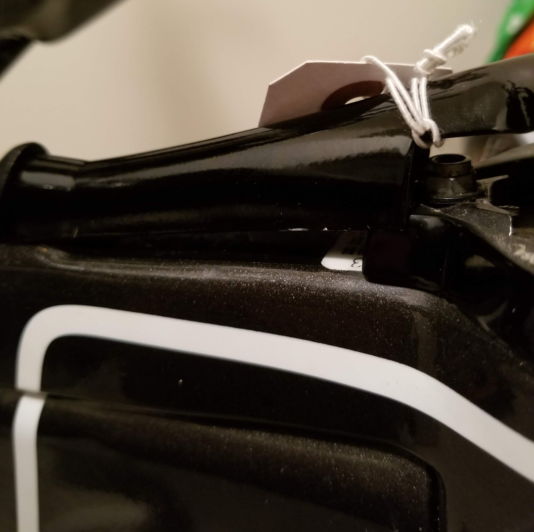

I’ve got a Large SC7 from 2014. Broke front brake cover but replacement cover is too long (W306640) - see photos.
I was thinking of trying a medium (W306643)? Or large brake cover from 2013 model (W328660)?
top end inserted first:
I just ended up sanding down the top of the brake cover until it fit. I left the little tab that helps hold it in alone. And just sanded down the sides and in front of tab until it fit.

Actually, looking closer that is a gen 1 cover. The gen 2 covers are straight at the neck. The gen 1 (and yours) has a slight indentation/overhang near the top.
If you got from LBS take it back and ask them to order correct part
