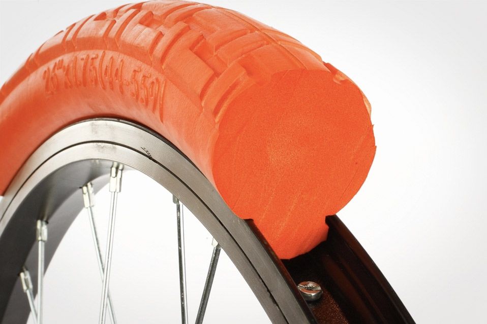

get a tannus solid tire

maybe if I post a picture too it will make much more sense to you why to use this tire on a trainer (tannus solid tire)
