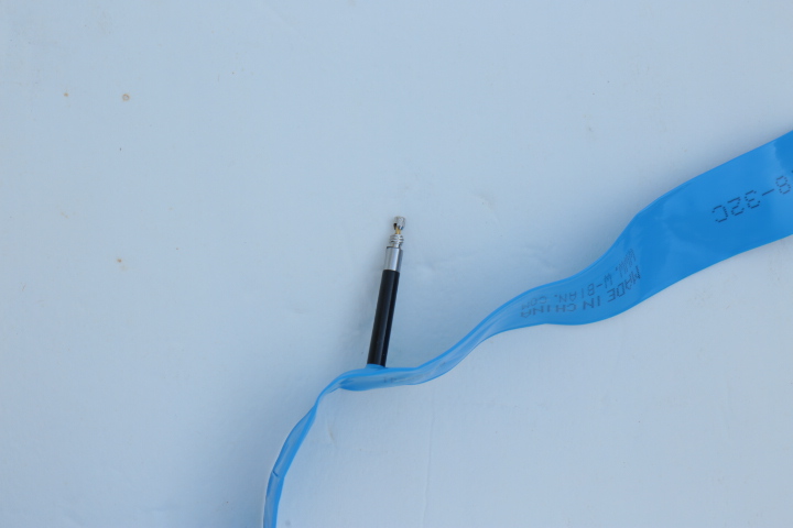

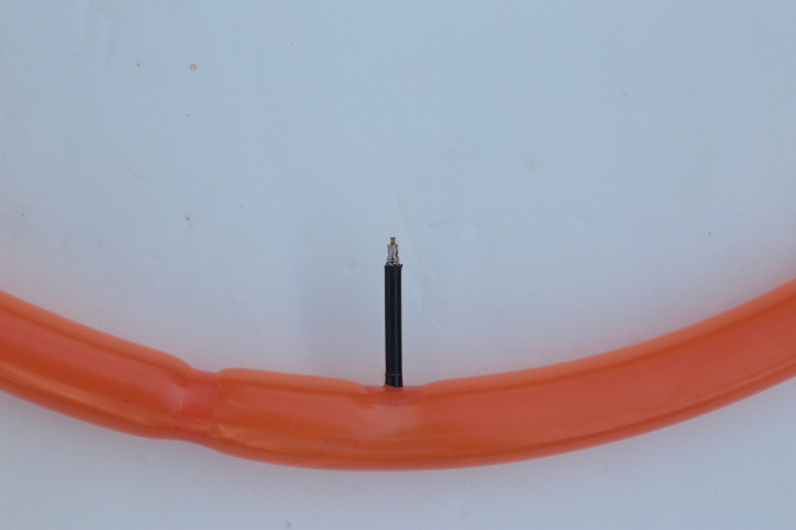

With one caveat, I’ve been having great success with TPU inner tubes. The one issue is that TPU tubes with an all plastic stem are prone to slow leaks at the valve core. They look like this -

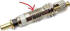

The fix is to back the valve core out, apply a glue like Pliobond only to the valve threads, and then reseat it.

IMHO, most of the TPU issues of them slowly leaking air is caused by air leaking right at the base of the presta valve where it screws into the plastic stem. Pump up with a little air before installing and test it in a bucket of water.
