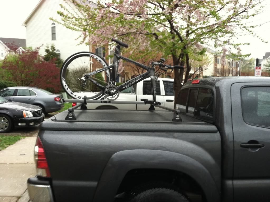

Update
this is the finished bike rack on the truck cover
http://i1135.photobucket.com/albums/m627/heliix1/Truck/photo9.jpg?t=1311689459
http://i1135.photobucket.com/albums/m627/heliix1/Truck/photo8.jpg?t=1311689679
