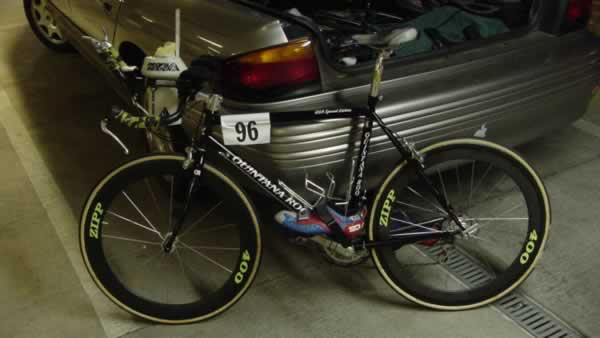

I use touchup paint on my wife’s QR USA Special Edition. Seems to work fine. Now that the multisport season is over, the plan is to do a complete tear down and rebuild and will probably sand and touchup. Do you have any pictures of this beauty you can share?
Yours:
http://ben.supervillains.org/ROO.jpg
Mine:
http://www.aliciaparr.com/pictures/tri/sprint/lknorm.2003/dsc03720.jpg
Enjoy your “new” bike!
Alicia

The white one is nice, but the black one is a BEAUTY!
