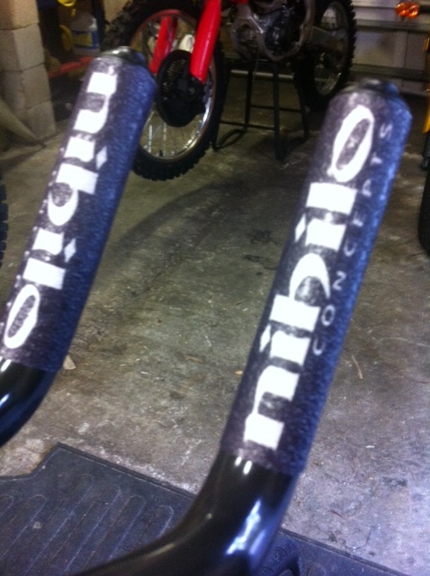

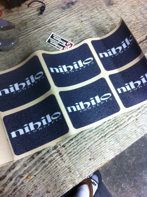

My solution
Isn’t that stuff crazy expensive?
My solution
