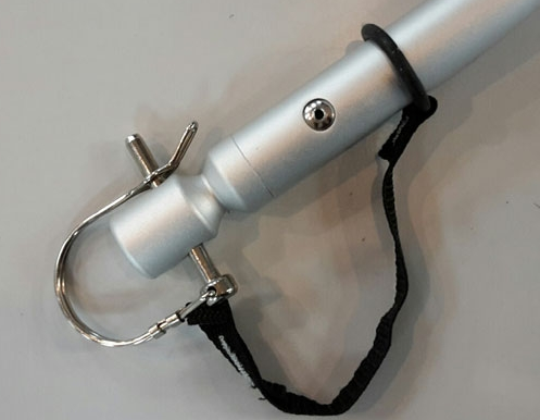

You are right, the old skiing set doesn’t fit the current chariot. I could test the old ski set of a friend yesterday, then I see were the difference is. The pulling rod of the modells before 2017 were fixed via split pin, the model after 2017 is fixed with a ratchet in the cicumference notch. In the picture below you see the current skiing kit. This kit could be also used for the older chariot.

The current Model, with circumference notch.
