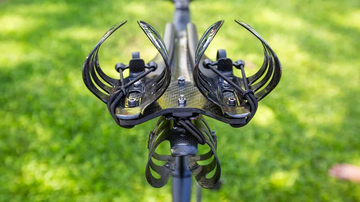

Interesting triple rear bottle setup for Ditlev. Most others going for 2,3 BTA bottles but he is sticking with just the one.
I am guessing he in on the Canyon cockpit ?
It’s interesting no Canyon athletes are on anything other than Canyon cockpits.
