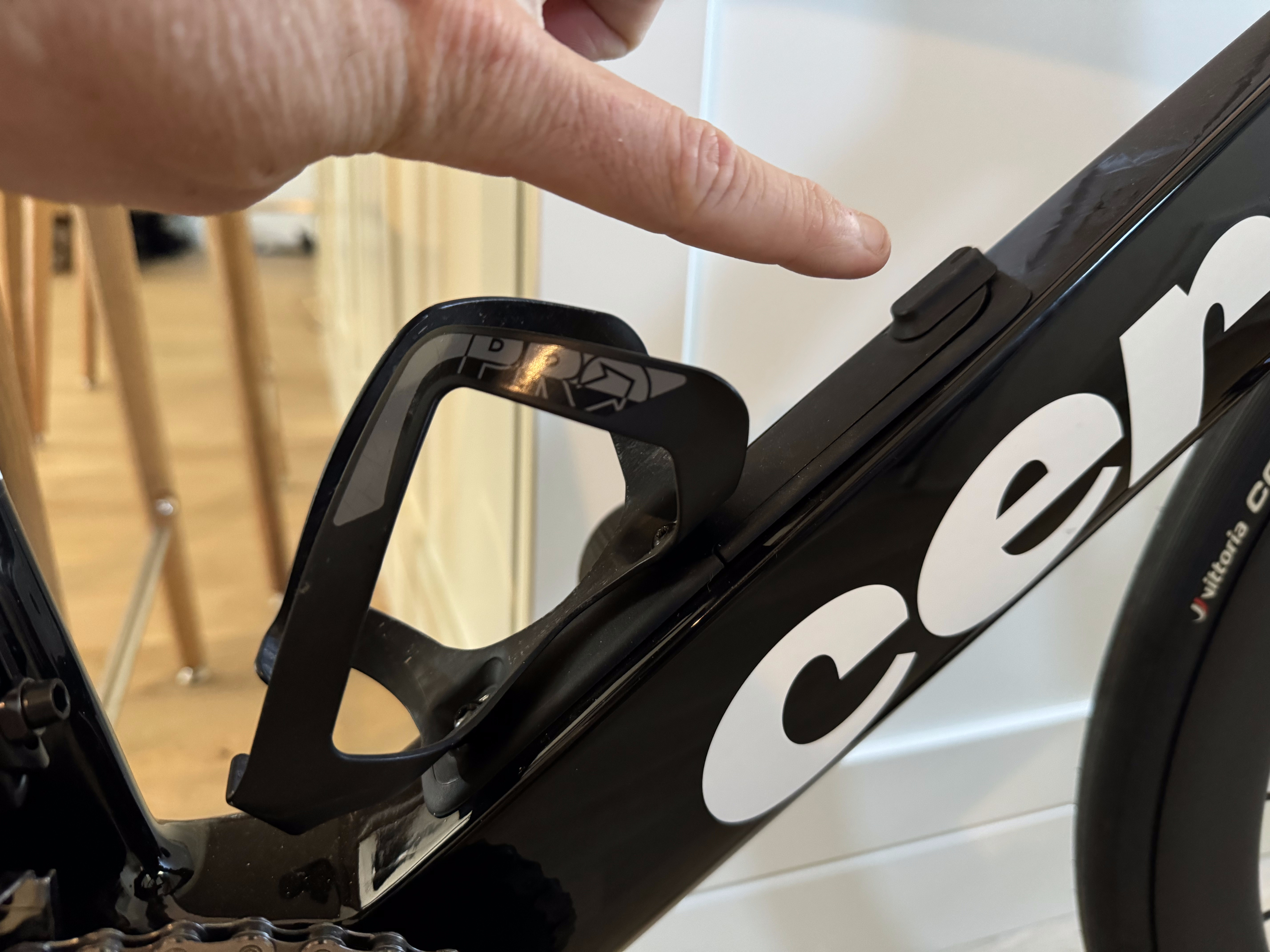

It has to do with this little sucker right here. The aero bottle requires a completly flat surface to be mounted. The locking handle keep it from being able to be installed.

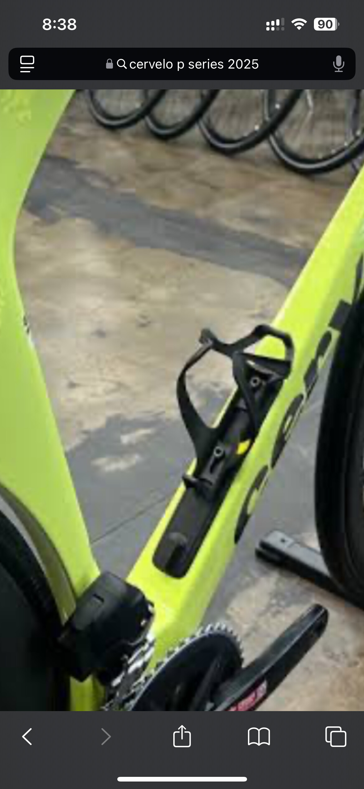

Those are 2.6mm washers, so I’d say 4mm would be ideal in order to have a little bit of clearance for the Profile Design RZ3.
Just checked the XLAB Aero TT as well - so you have at least a couple options for aero bottles!
It fits as is (utilizing the slots and our already included larger washers) to move it down, but we added an additional washer to both bolts underneath the cage and clears the switch nicely.
Try turning it another way around like this
