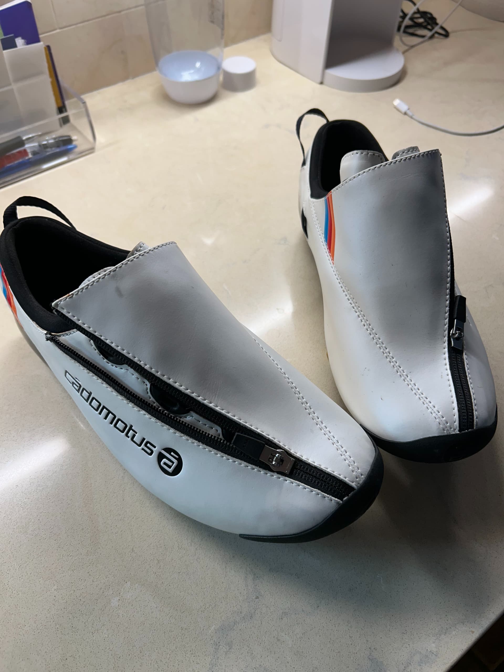

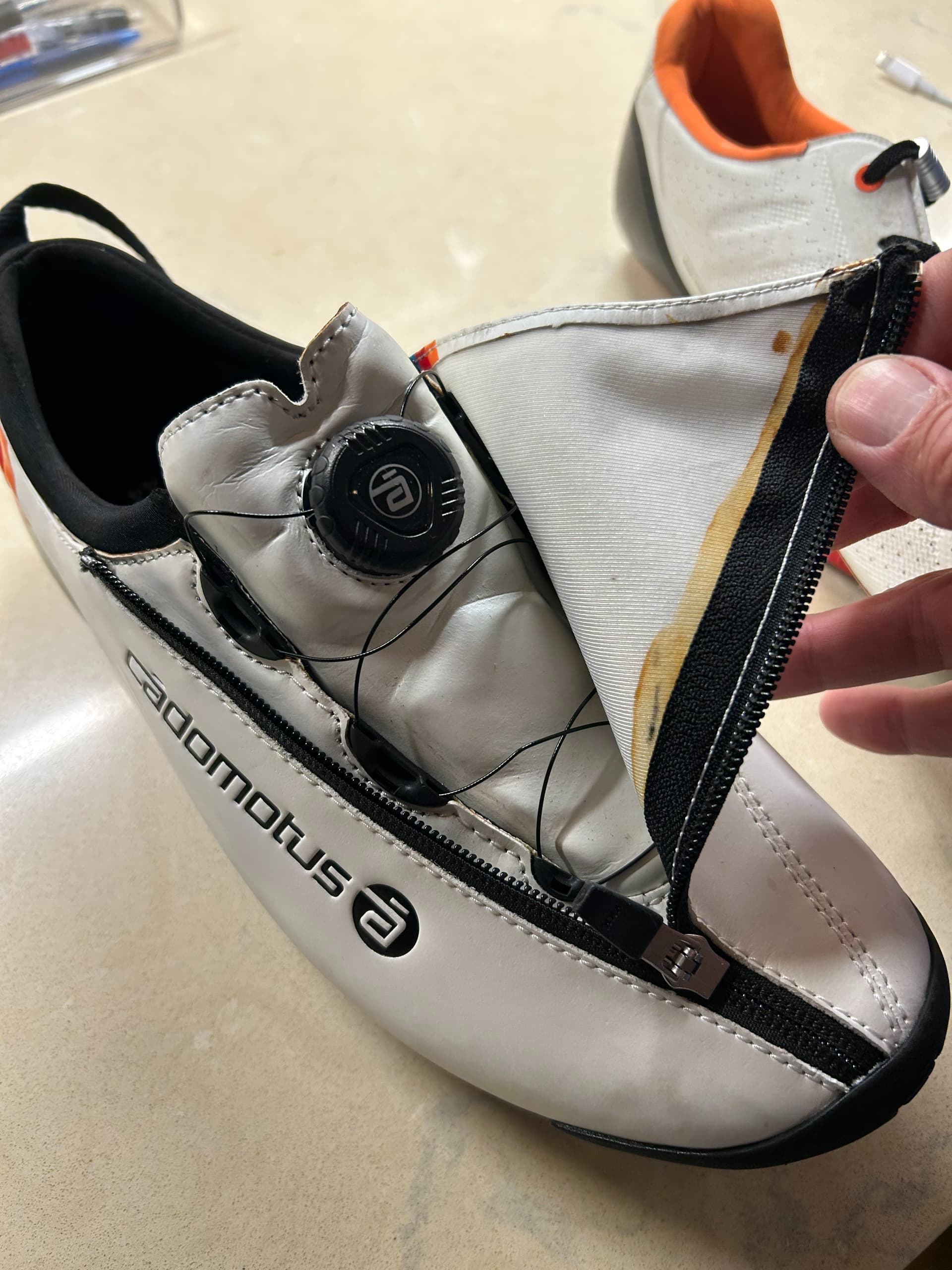

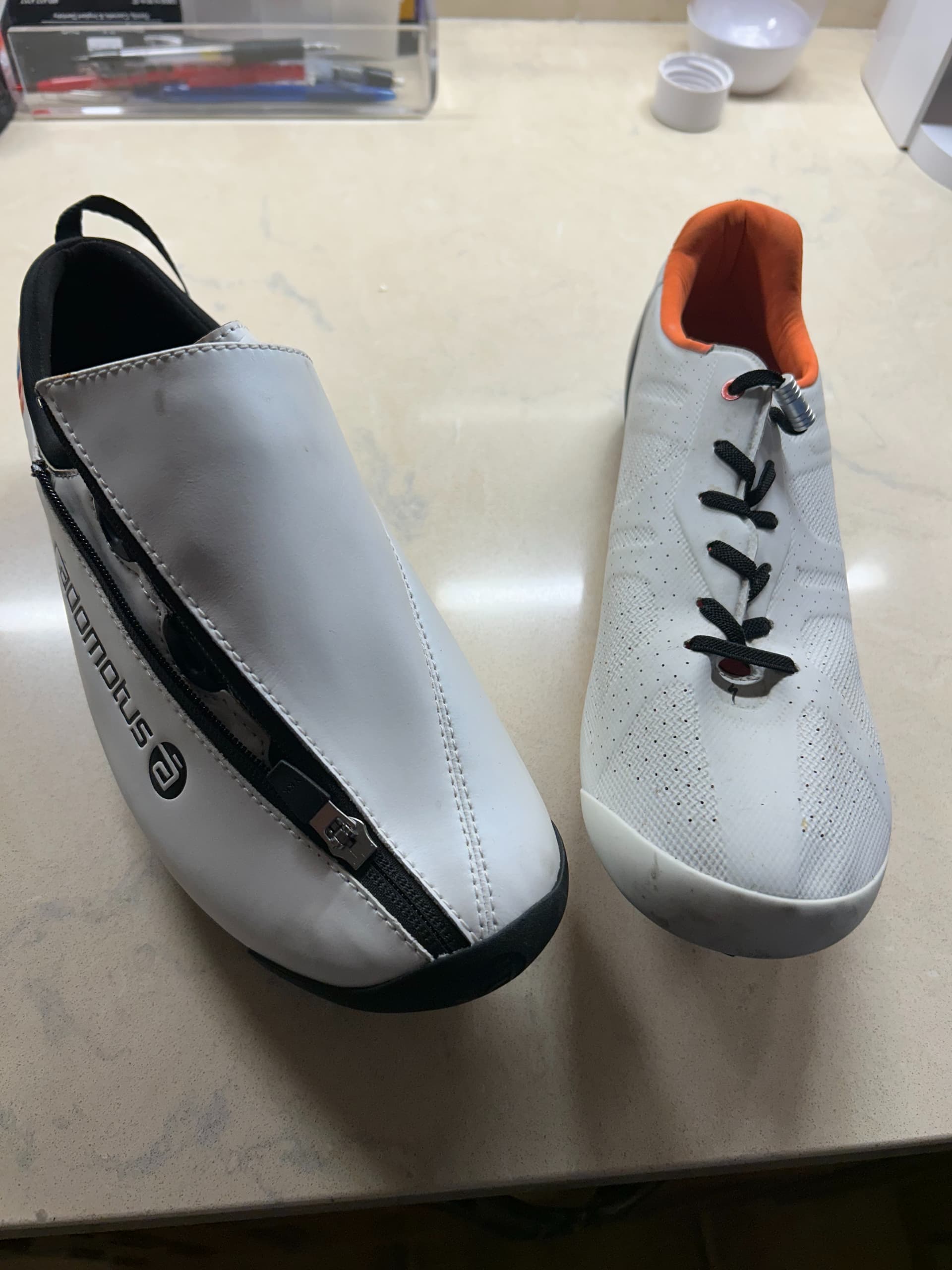

Due to fortunate geography, this was my third time testing with Brian, @desert_dude, in Tucson. I once even had the pleasure to meet @marcag one time. I have a whole new bike set up this year and I was curious about the Rudy Dream vs. Wing, Multiple stacked BTA bottles, calf sleeves, and a new shoe company called Cadomotus , Cádomotus Transition bags and Aero helmets for Triathlon - Cádomotus Sports, vs. my Specialized S-Works Torch. Cadamotus comes from the Speed skating world and hava shoe called the Chronos Aero that resembles the Bont’s.

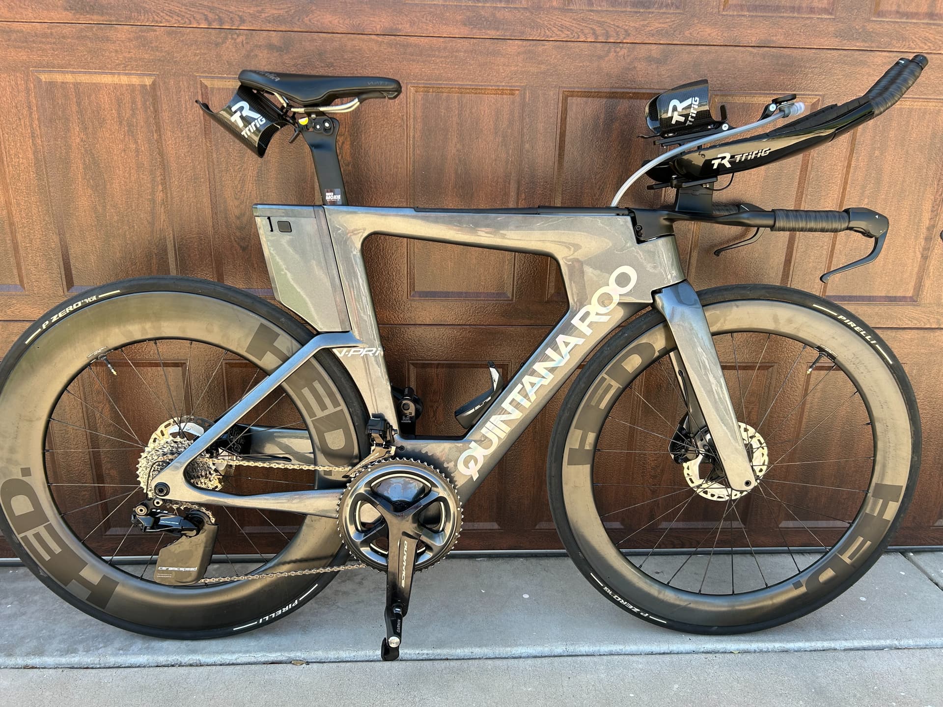

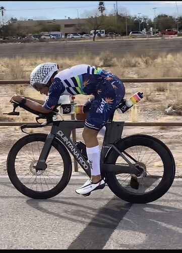

My bike is a QR VPR-i with TriRig Scoop Ultimate extensions. The only difference to the pic below is I added an angled spacer to the BTS bottle so the cage wasn’t angled down but is horizontal. These are also the wheels used as I wasn’t looking to test with my HED 8/Disc race set up.

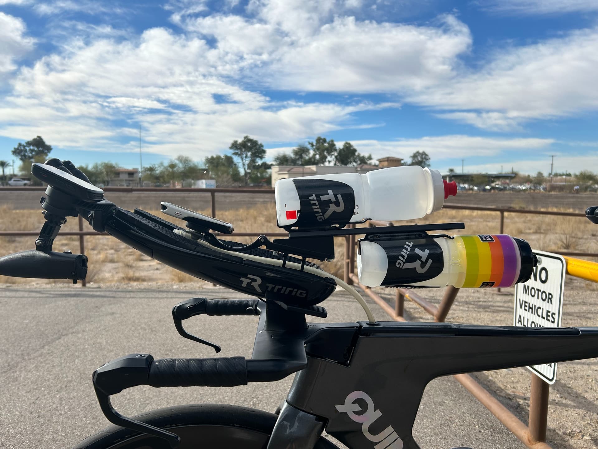

For the stacked bottle test, this was how we arranged them.

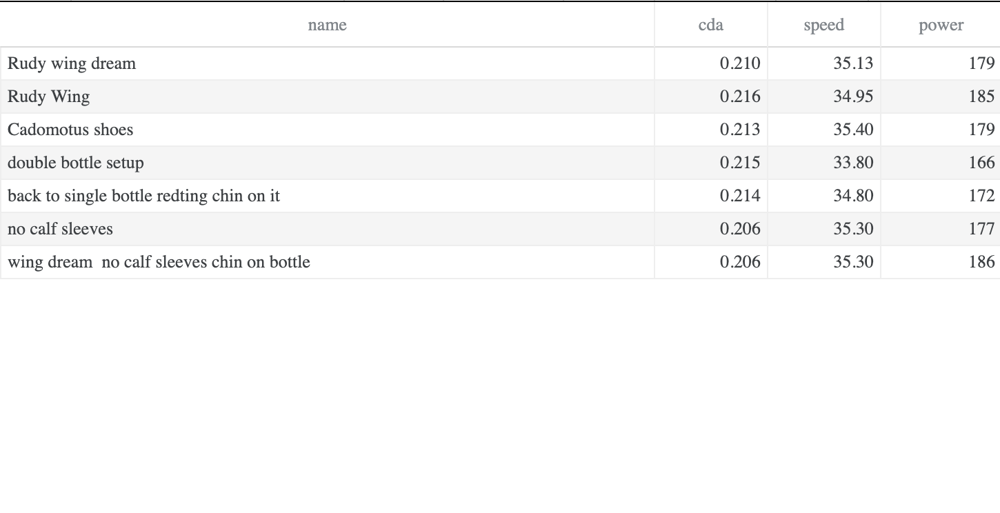

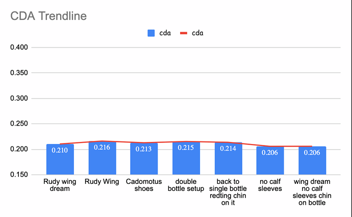

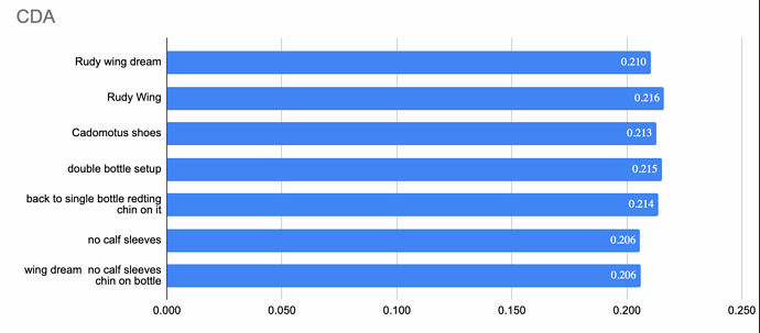

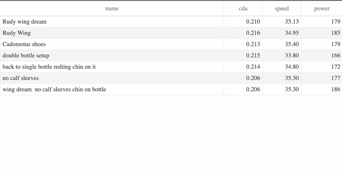

The Baseline runs were with the Rudy Dream, I should have started with the Wing as it’s what I have been using, The Torch shoes, Zoot calf sleeves, and a single 750ml bottle BTA. We then did runs with the Wing. The Dream run produced a .210 while the Wing was .216. Then we switched the shoes which brought that .216 down to .213. Keeping the shoes and the Wing still, we went for the stacked bottles. Those runs produced .215, so for me that got worse. Leaving on the mounting bracket that provided about 10mm of lift to the BTA single cage allowed me to rest my chin on the bottle while in aero which brought is down slightly to .214. Lastly we removed the calf sleeves and I had a very low .206. In defense of calf sleeves the next day Brian tested someone who had aero socks and the calf sleeves were faster. He has no idea why he see’s so much variability with sleeves and maybe he can opine. Last runs were Dream, Chrono, one bottle, no sleeves. Here is the data:
So I probably saved 7-9 watts by fine tuning the equipment choices which tested best for me. Maybe :90 over a 56 mile ride. Here’s a shot from the test to see my position. Yes, my seat may be too high. :slight_smile:
If anyone has any questions, ask away! Hopefully @desert_dude and or @marcag wil jump in as well as I’m a dummy. One thing I would like to add regarding the Chrono shoes. These are molded to the riders foot via heating them in an oven to acheive a great fit. I borrowed these from someone who had already molded them to their feet so they didn’t fit me great. With a terrific fit, I wouldn’t be surprised in the power transfer with them is superior to the Torch with the elastic laces as those laces will expand slightly on the pedal upstroke, potentially losing power transfer.

My thought was just if you’re really comfortable at the front or if bringing the front up a little would feel nicer with no penalty due to the bta bottle setup?
Any thoughts on keeping the rear axle removal tool installed? No penalty to leave that in?
And then with the 3 bottles plus the in frame bladder hydration, do you still need that aero frame bottle? Doesn’t that still have a penalty or are we seeing that filling in the frame as much as possible is better?
Brian suggested raising the front end 10mm and bringing the seat down a bit. I really didn’t even think about the axle tabs. We talked about the down tube Crono bottle and he said it can be of some benefit in crosswinds. I actually use that for gels or solid food. I don’t need that for 70.3 racing, just full IM’s. So just one BTA, the internal bladder, and one BTS is how I will race this year. That’s what I did in Kona.

Any thoughts on why dream seems to be quicker than wing on first runs but we dont see that in the last runs? Am i understanding the data correctly?
Thats a huge penalty on calf sleeves on you!

I saw the raw data, I can add some light on what I saw.
The “no calf sleeves” had 2 runs, one showing more improvement than the other. The lowest run “could have” been weighed lower (more noise in it) bringing that bar slightly higher. Bottom line is both tests showed the calf sleeves to be slower. My “bet” is if their was another run or two in that configuration, the second to last bar would have been a bit higher.
But at the end of the day, the calf sleeves were slower. Maybe just a little less than that shows.
Interesting on the shoe result.
Dowsett did a similar test with the Bont Zero+ vs Torch in a wind tunnel.
In that test the results were flipped. With the Aero shoe (Bont) surprisingly slower.
Yeah I was aware of testing showing the Bont not performing as well including that one. I’ve never held one in my hands to know how it would have compared design wise to the Cadamotus. I have been racing the Torch for 2 years knowing it was considered a very solid aero option. The other thing I should mention is the Chrono’s are much heavier than the Torch if that plays a role in someone’s choices. But as I also mentioned, the fit of the Chrono being so custom is much better.
I guess I would add that the Chrono looks like a much cleaner, less bulky design than the Bont after rewatching that video.
