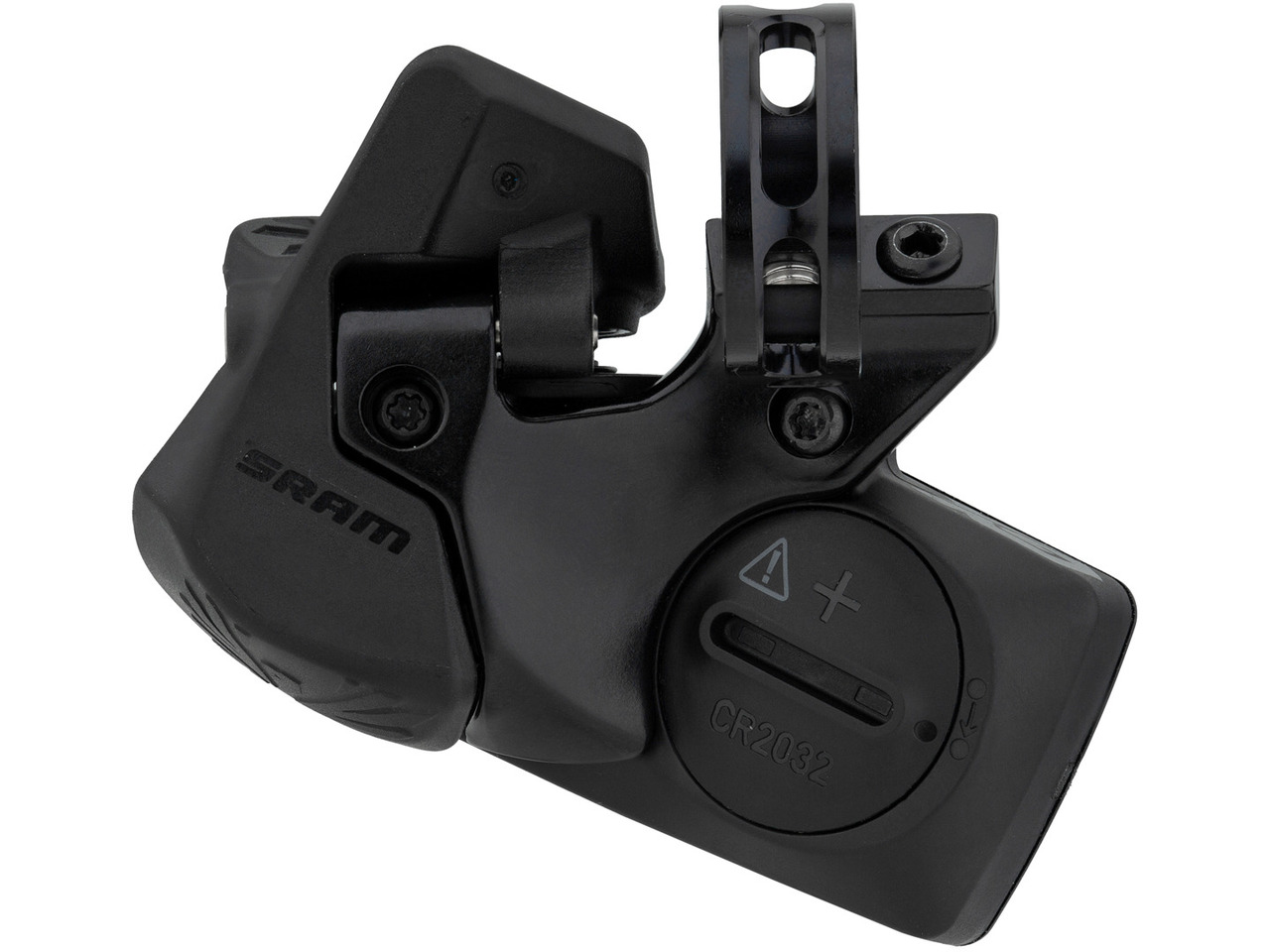

If you’re committed to 1x, don’t care about shift buttons at the bullhorns, and can be a little crafty with the mounting, you could replace these both with the $150 GX AXS shifter.

If you don’t care about shift buttons at the pursuit position, and can be a little crafty with the mounting, you could replace these both with the $150 GX AXS shifter.

well, now you’re thinking! that’s 1 unit, that would shift a 1x up and down. 1 shifter on 1 extension. or on a bridge between the extensions. yes?

Yeah, I’ve only thought about it as an academic exercise; haven’t actually tried it. But this would absolutely work in a 1x situation. Don’t know enough about AXS to say if it will work with a 2x, so I amended my original post to qualify it for 1x, but I could see how it might be possible to use with a FD if you use the app to set up sequential shifting.

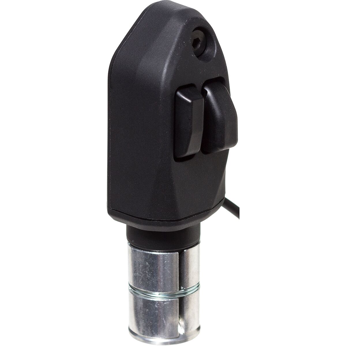

Since this launched slightly before Rival AXS, I was a little surprised SRAM didn’t offer something similarly priced with Rival that mounted to an aerobar end. Maybe something that looked like the Rotor 1x13 TT shifter.
The Eagle GX AXS shifter body seems to be closed by screws? It might be hackable? Would be a candidate to make a small case and add some custom blips.

i have a question into SRAM right now. i don’t know that you need to hack it. because it’s closed by screws and uses a common coin cell battery it’s got a semi-infinite life. my question for SRAM is whether that shifter is compatible with the road derailleurs and can work just like road shifters in the AXS app. i suspect that’s all cross compatible. what i don’t know is how ugly or nice those shifters would be as bar end shifters.

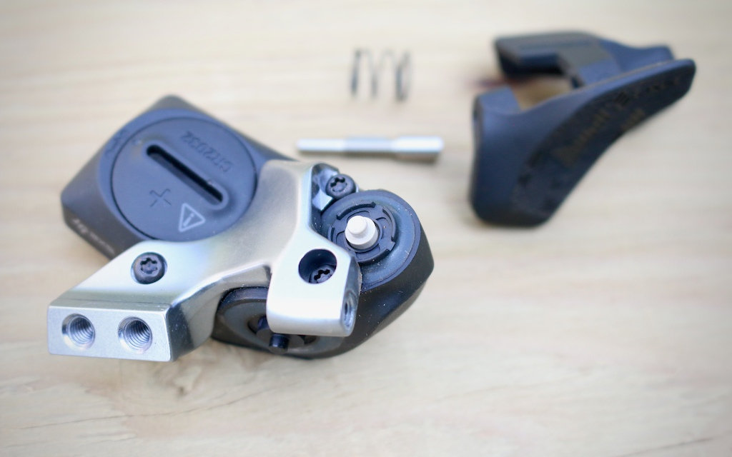

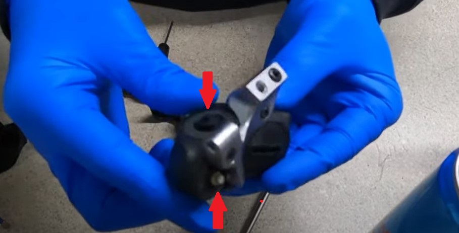

Yeah, if you’re really handy and willing to take some risk, you could presumably hack this into a cheap “blip box” for your own blips. If you take the paddle off (a user-serviceable procedure, as they have an alternate part that more closely mimics the operation of a standard MTB shifter), there are two small buttons underneath.

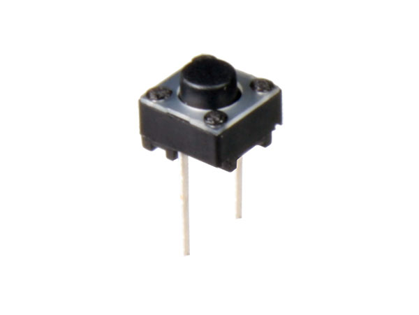

My guess is that, underneath the waterproof cover, their just basic circuit board mounted buttons.

With a soldering gun and a little nerve, one could probably replace them with wire some wire leads that would go to whatever blip-style solution you wanted.
Again, this is all a theoretical thought exercise. I haven’t actually had one apart.
After a quick Google search this looks very doable. Maybe even without hacking but simply by removing the stock MTB handlebar mount and paddles and replacing that with something you could attach to an aero extension plus a more compact paddle design? If that fails, it looks like the case can be opened and taken apart. See images below (source: first two Sram, third Pinkbike).
