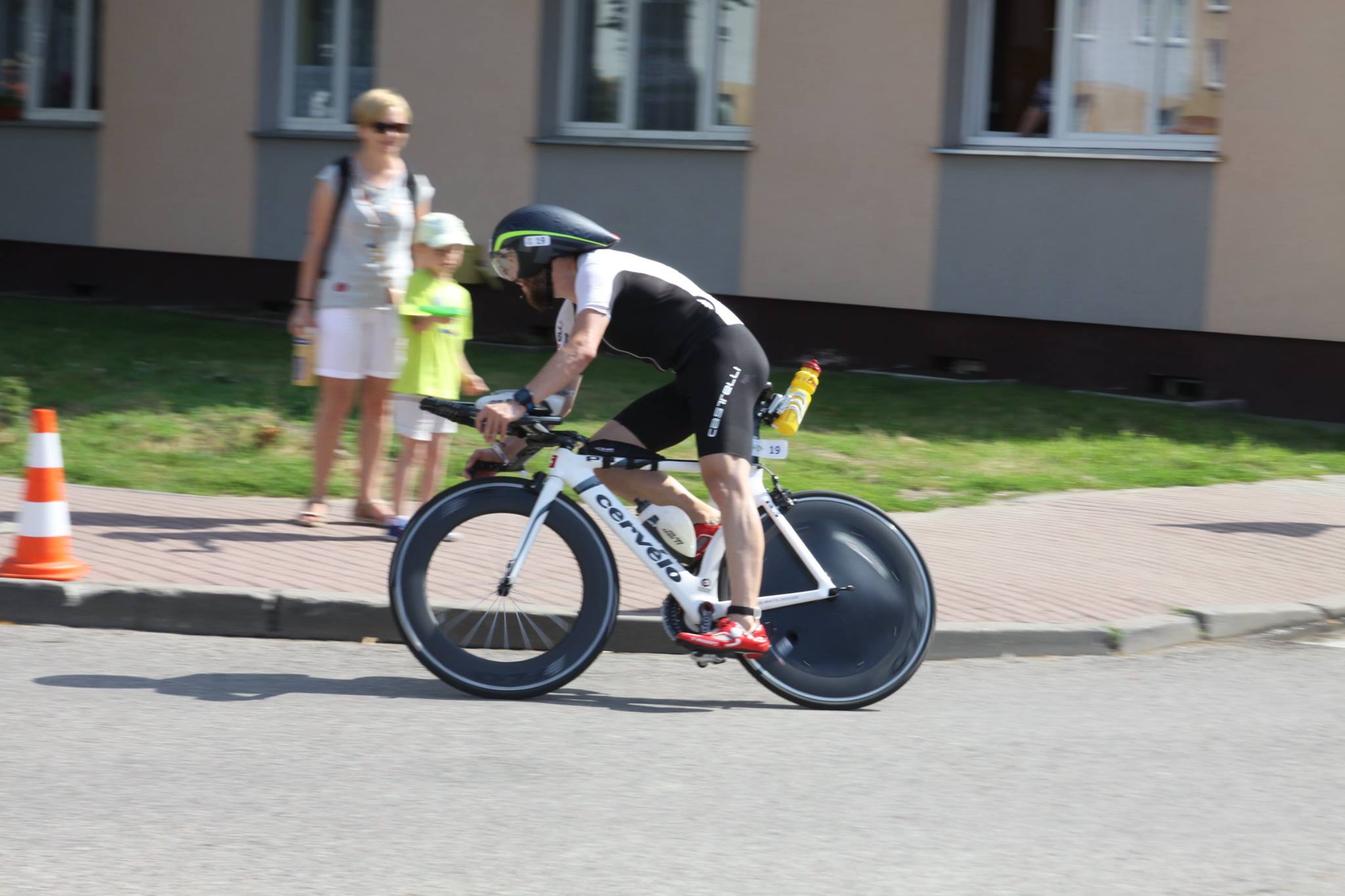

Currently I’m riding moded P3 size 51.
Ummm that bike you are riding there is plenty fast. Not sure if that is a race picture, but my 2 cents is you will gain more time by upgrading your “kit” then upgrading the bike. And not sure what aero helmet that is. But rather than a new bike, time in the tunnel would more than likely return bigger gains as well.
whatever bike is most expensive
This is my race day kit - gave me 2h04’30" - 43.2kmph
Helmet is Met Drone WB - same as Frodeno (during Barcelona 70.3 he was faster by 2’40" on the bike)
Course and race name of where that picture was taken and the 2:04 was ridden?
Your current setup is still solid and I don’t think you will be making huge gains going to a P5 or Canyon Speedmax. Waiting to see what they do with the P6 isn’t a bad idea, unless this said money from supporter/sponsor has a time limit on it.
What Brad is saying is that there could be some low hanging fruit via slight position tweaks, clothing choices, etc. found in the wind tunnel that cost much less than a new bike and would offer greater gains.
Your race top is kind of loose which means you’re not as aero as you could be with a tighter and better fitting top.
The Met Drone might be the fastest helmet on you or it might be the 8th fastest helmet on you. Just because it works great for Frodo doesn’t mean it works great for everyone. That stated, it looks like it matches well with your riding style.
Unrelated, how did you attach your aerojacket. Looks like you used different fasteners to the ones supplied.
Fasteners taken straight from the parcel send me by wheelbuilder. Simply it fits Flo90 perfectly.

They’re not the fastest if you fit awkwardly on them. You want the FASTEST for you, not the FASTEST riderless in a wind tunnel.
you’re set up pretty low on a bike that is one of the lowest around. I’m not sure you’d be able to replicate that on any of the current bikes.
This was already discussed some time ago - with P5 it should work with one spacer and low stem.
But in general this is a good suggestion.
That P3 is a fast bike. I have a 1st, 2nd and 3rd in the last three National Championships that i did on a p3 and a Hour Record on a p4. Not that those results scientifically means anything, but I could have any bike and for now I am sticking with the long and low bikes, p3’s and p4’s. With a rider on them, most modern aero frames are very similar in drag, where as, small changes in position can have huge results. You want to get faster, its all about the fit and position. Go to a tunnel with a good fitter and keep working on getting lower and narrower. I am a TTer so you may not need to be aggressive as me but you have tons of room for improvement.

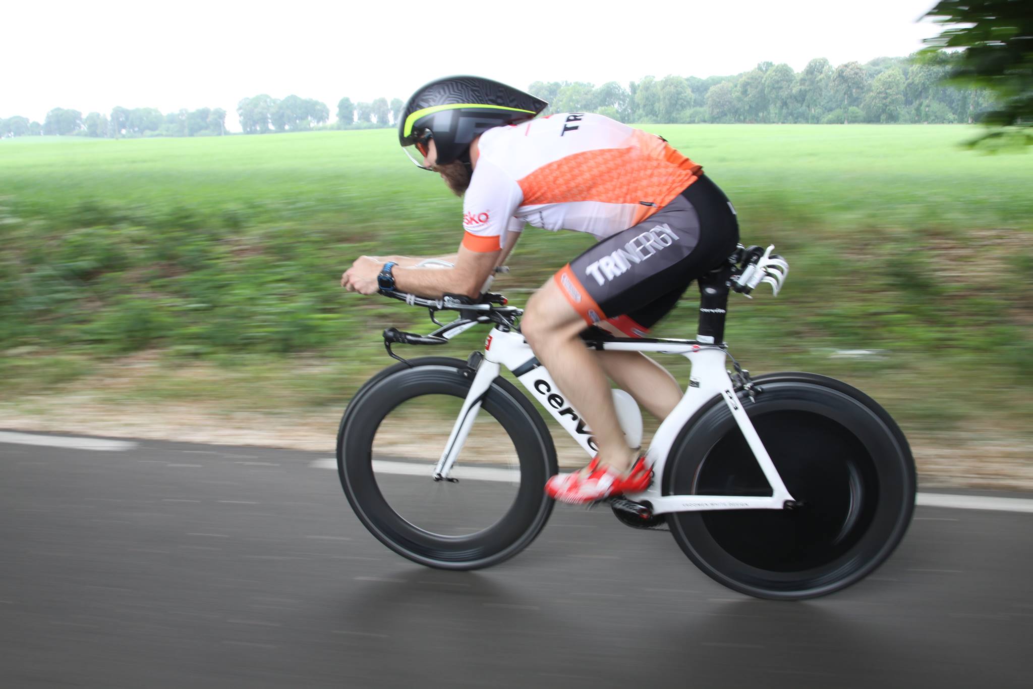

You do not need a faster frame. The engine is amazing and what I see is a few upgrades.
Wind Tunnel Time - The most important factor.
Clothing - something tighter and proven in the tunnel on you.
Helmet - something that works for you and proven in the tunnel on you.
Sram eTap TT - no exposed cables other than your rear brake housing.
TriRig - Omega X front and rear and Alpha X bars.
Bottles - BTA and behind the saddle only. Remove the “maybe aero” aero bottle on the frame.
Other options - 1x11 set up on the front and remover the FD hanger if possible. Not sure on that frame how easy it would be.
Tunnel testing should be the main item and the other items will help a bit as well.

Wind Tunnel Time - yes, but it won’t be ease to get it in PL. One company is introducing Alphamantis so probably I will give it a try.
Clothing - racing in Castelli Body Paint SR Short Sleeve - IMHO already good piece of cloth
Sram eTap - the only 2 exposed wires from di2 are one behind the stem and one going to rear derailleur
TriRig - front is ‘regular’ Omega, rear is Ultegra (swapping for omega could potentially save 0.5w)
Bottles - i’ve got gels inside, for 70.3 i could get rid of it, but then i would loose time and speed on playing with gels in sachets.
