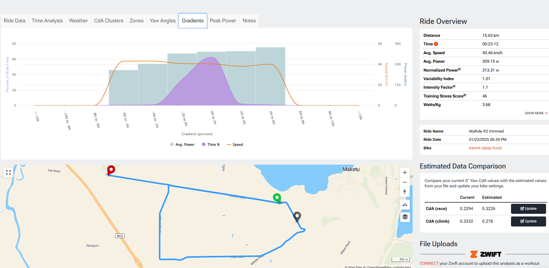

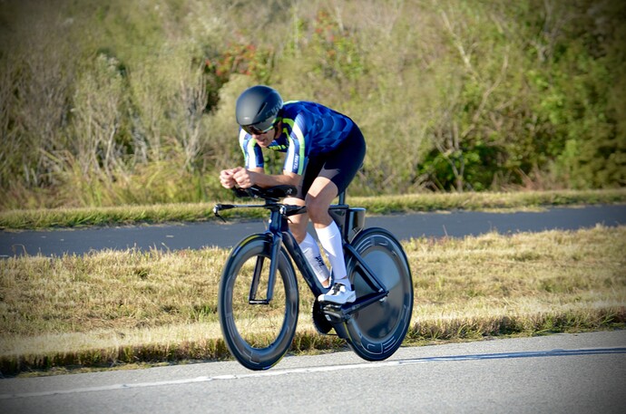

My guess is that you are way way way off your FTP power when racing. FWIW at 85kg and 6’4" I was pushing NP310w / average 306w for our club TT series and that got me 2 wins and 1x3rd. Speed concept, LG p-09 helmet and 80mm Bonty wheels averaging 40kph. Under no illusions I was the fittest or strongest there (even I was +20w a few years ago) but I was certainly much further into the hurt locker than anyone else.
To be really good then you look at the UK Timetrialling scene then you also need to be in a position that in itself is torture to be in for more than 30seconds, and hold that for 50mins whilst putting out 400w…
Congratulations on your wins
310 w for 40kph
How hilly was this course
I suspect your kicker is reading too high. Mine is high compared to my 2 taverns by 15 to 20 watts.
Not very, 43m over 16km.
Overall then slightly wind assisted but equally the road surface is mentally rough/slow chipseal.
