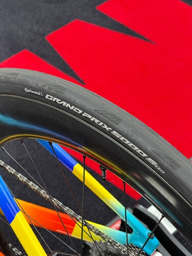

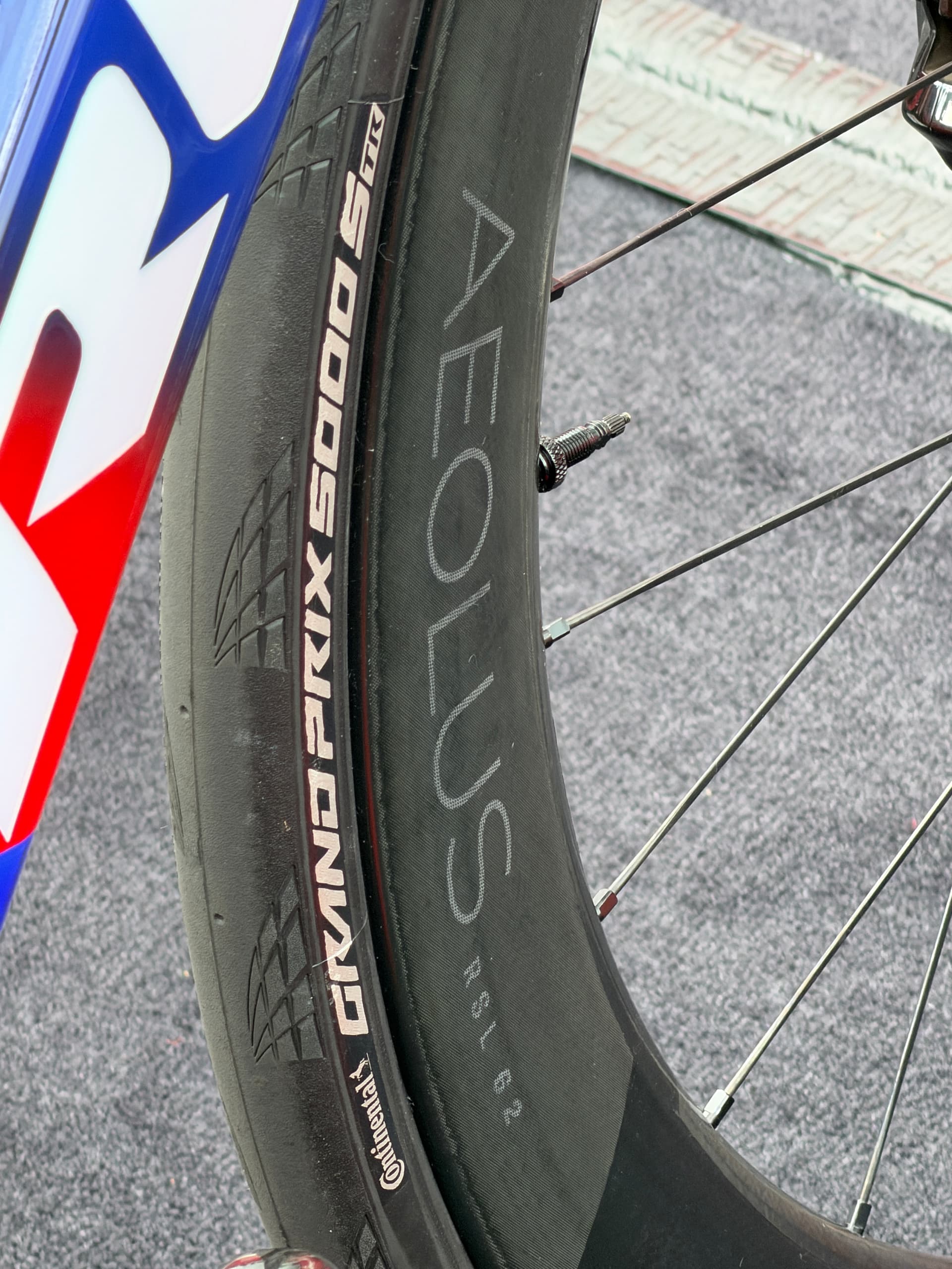

I, like many, really like the after-the-fact bike pictures and info, but pretty please, try and include front tire size and type (or a close-up pic of the valve stem) for all of them.

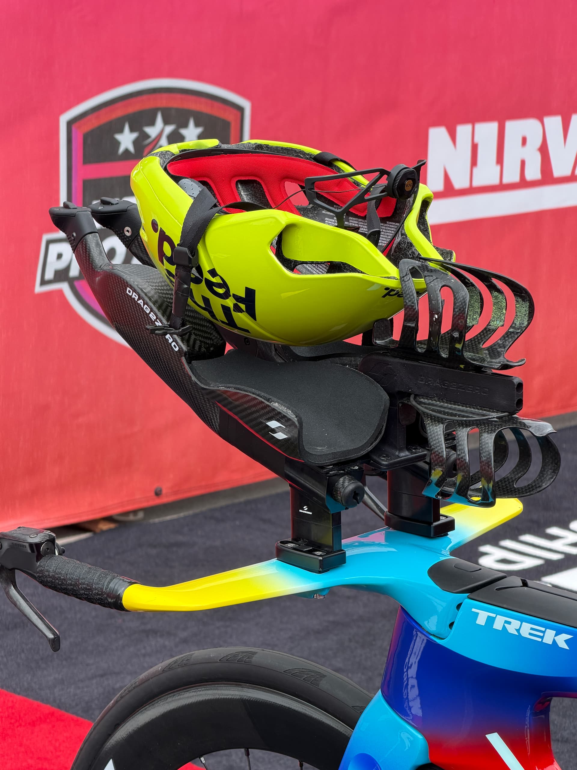

Road helmet…

In speaking with Taylor.. she basically wanted you all to know that she doesn’t like the other tires.. and the road air helmet tested faster….

Foley wore a road helmet last year and did pretty solid for ~111 miles. He’s said repeatedly that he will take comfort over a couple watts.

Small difference, but I’m not sure how that math works out. The formula is RR (Watts) = CRR * speed (m/s) * load (N) (from BRRs website) and hence should, for tires with coefficients of 0,00291 and 0,00249 respectively, be in the ballpark of 3-3.2w for the system (assuming system weight of 65-69 kgs, speed of 40km/h). Right?
You are correct
I would say knibbs system weight is more like 70 to 75 kg
And she likely will go a tad faster than 40 kmh
So if we go with 75kg at a 4h20 split, we are at
75 x 9.81 x (.00291-.00249) x 41.53 / 3.6
~ 3.6w ?

Using this An interactive model-based calculator of cycling power vs. speed , 3,6W would mean about ~1m30s difference over the distance at that speed (given som napkin guesses of CdA etc etc.) Now it might be somewhat less than a minute, or maybe over two, with all the unknowns here, but timewise more than I thought with a power difference that sounds smallish to my untrained ear.

But still we are talking about 1.5 percent more watts she has to push to go the same speed.
