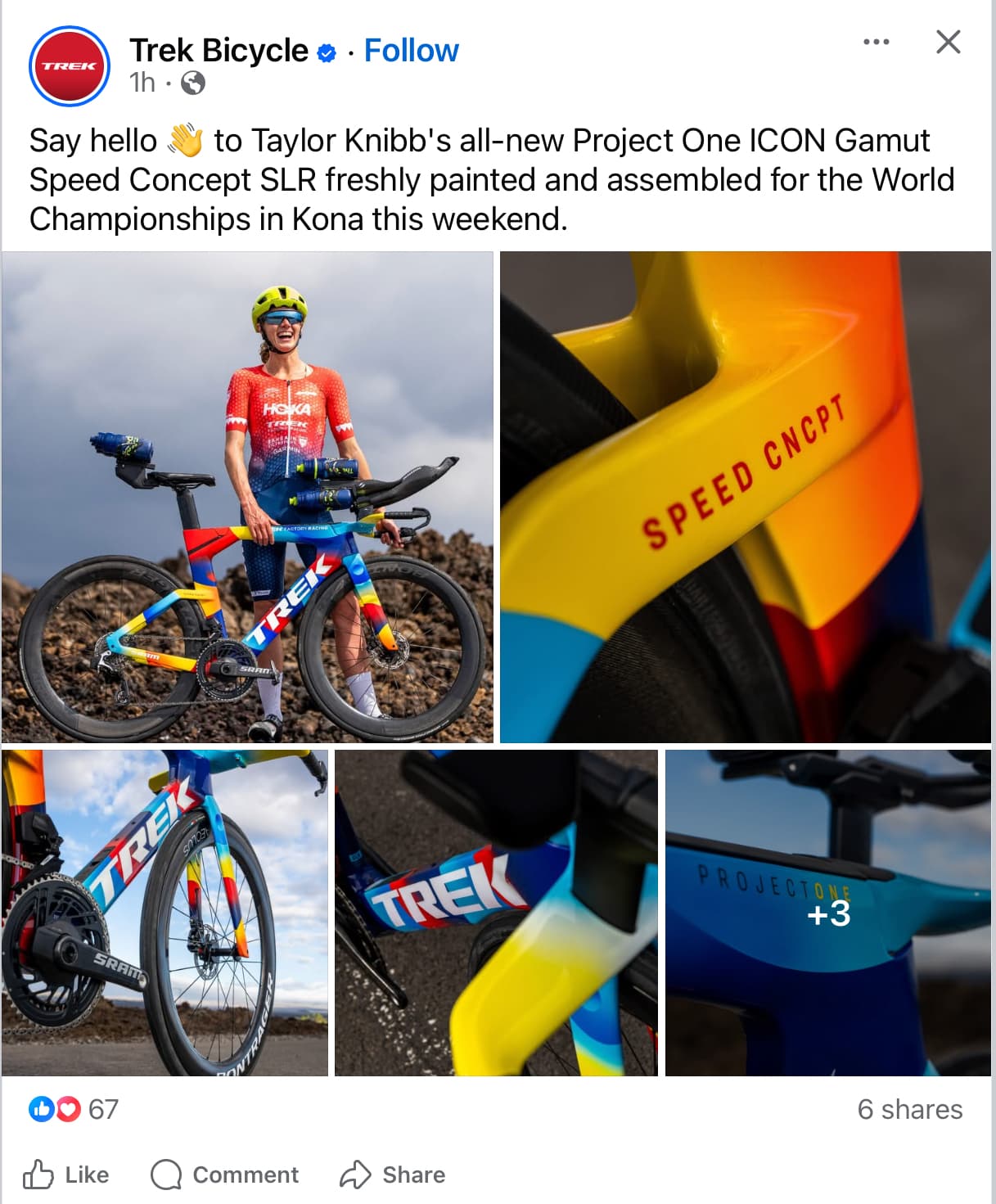

Trek just dropped these on FB…
I think it looks kinda cool.
Colorful, bright, Kona…
I like it too, it looks very similar to the Lidl-Trek factory team bikes.

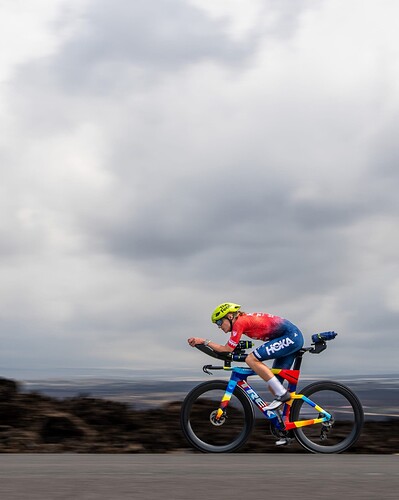

She just posted this: https://www.instagram.com/p/DPolBHMDnl1/
She says she’s on 172.5mm cranks and appears to be poking some fun at this thread.
Google has her at 5’7” so it’s not height — I wonder if she is just naturally a grindier, lower cadence athlete.
Maybe she just has really long legs.
I didn’t take it that way. I took it as she’s not a huge tech person or bike guru and couldn’t tell you much else about the bike.
She’s running a Bontrager R3 front tire in one of those pics.

I reckon it looks absolutely awesome! Heaps better than the boring monotone run of the mill stuff we have seen a million times before over the last 200 years..

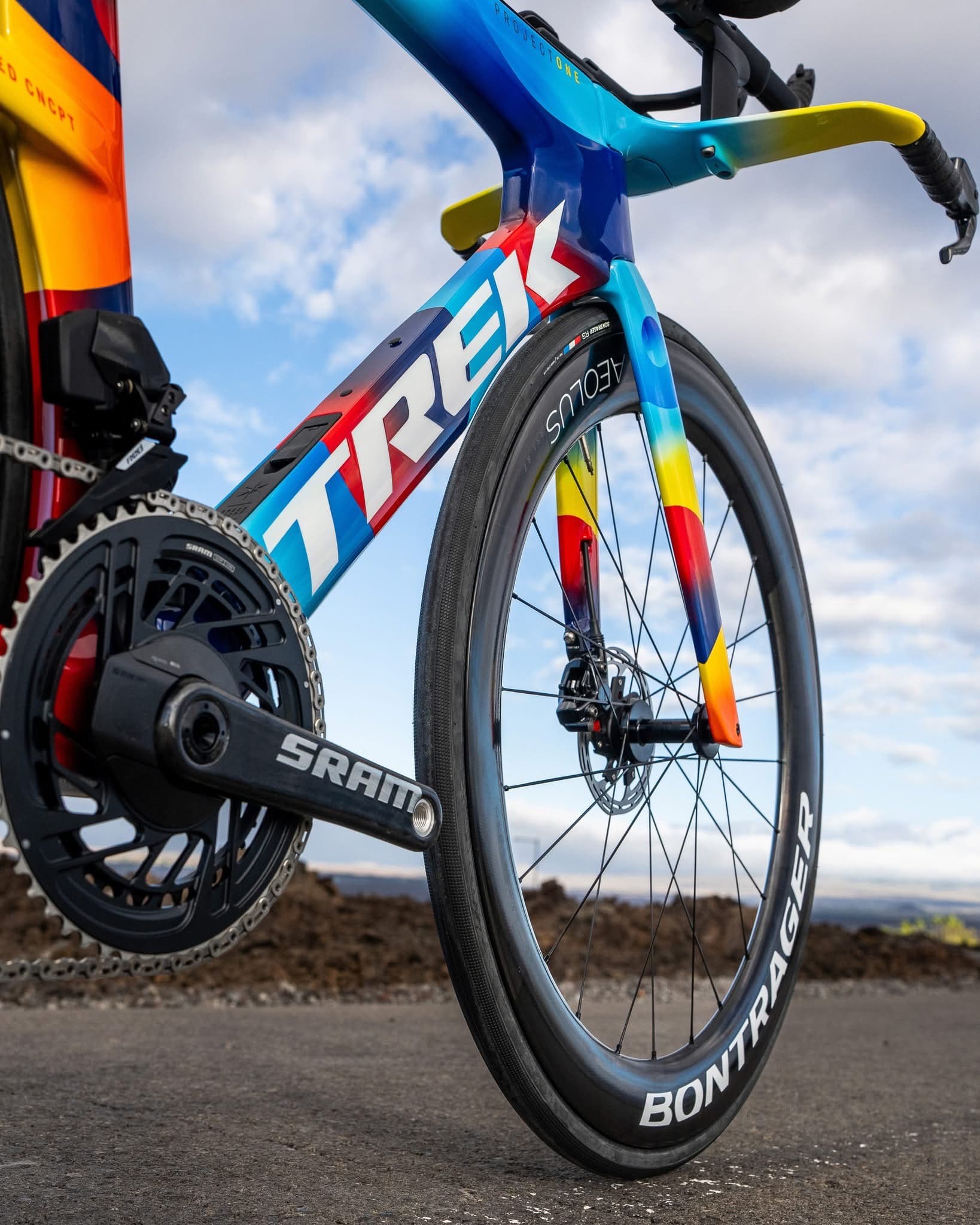

Interesting how the strongest legs in women’s triathlon hasn’t gone for a 58 chainring like many of the others..?
Knibb has a SRAM 10t though whereas think all those on a 58t big dog are Shimano with an 11.
Yes, that’s 5.4 wheel rotations per crank rotation vs 5.27 wheel rotations per crank rotation or about 2.4% higher gearing with a 54-10 vs a 58-11.
I see the 00:00:00 is gone on these - I’ll be honest I still don’t really understand what that stood for. Although the Speed Cncpt made a tiny bit of sense on the fork for space, then on the seat stay I’d have thought that they could have had the name in full.
As for the paint scheme. These are pro bikes at the world champs. They are designed to be highly visible, not win the concours d’elegance. I admit Cube have been doing a great job with both for Lucy, the T100 London Underground being a real win.
