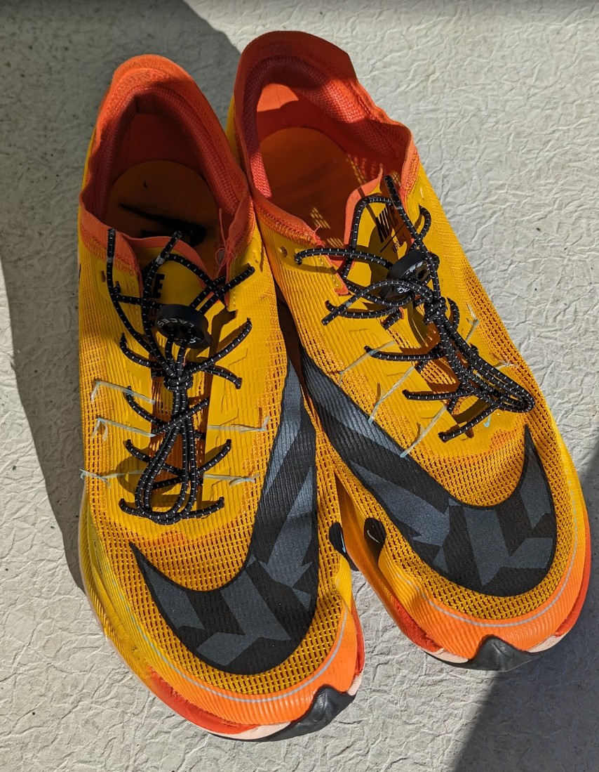

I love the feel of running in Nike Vaporflys (I have the v2, haven’t tried v1 or v3), but I’ll be darned if the tongue isn’t the most finicky thing. Sometimes takes me nearly a minute per shoe just to fix all of the weird wrinkles that occur when I put my foot in. Which really kills their appeal for triathlon, since the goal is to put them on quickly in transition.
I have a race coming up soon, so I’ve “sewed” the edge of the tongue to the upper using dental floss. Another kind of thread would probably be fine, I had floss on hand and it’s a little stretchy which is nice. It seems to work pretty well – no more wrinkles.
Anybody else have a solution for avoiding Vaporfly tongue issues in transition?
