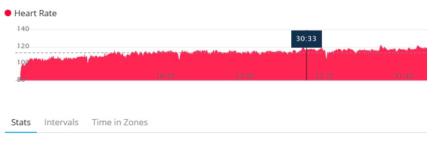

This does not really solve your garmin load issue, but I use polar OH1 which is awesome. Amazing how small it is and so much more convenient than chest strap
It comes with a plastic thingy to hold it on swim goggle strap and can record heart rate during your session.
After you are done you sync it to polar’s platform (flow), download the file, upload it into trainingpeaks and merge with the garmin activity file
A bit tedious process, but there’s no way to get it direct from the 935 wrist monitor.

As an update- I have had a few swims with the oh1 now, and it works really well. It just sits there and afterwards gives a good measure of the effort I put in to my swimming. I had found that just using my watch didn’t show as much effort, even though I was trying hard, as I am not very fast!
