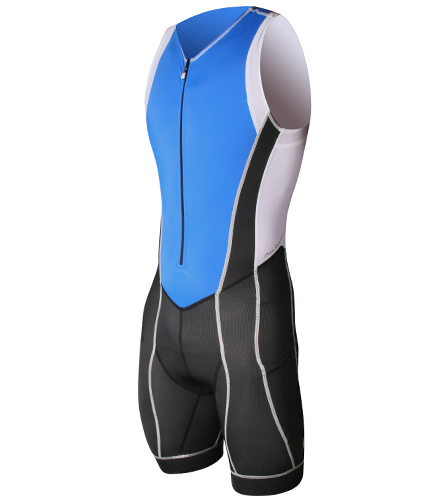

Had an old De Soto (2009 Forza?) similar to the photo (with 3 mesh pockets in the back and 1 on each leg) and was a total drag suit.
Didn’t like the chamois, either.
Worn once.
I use the same in non-wetsuit races and per Emilio’s recommendation (on this forum, noless) I used fabric tape to close up the back pockets, and I don’t notice any appreciable drag. The side pockets don’t create much drag.
And I like the chamois.
