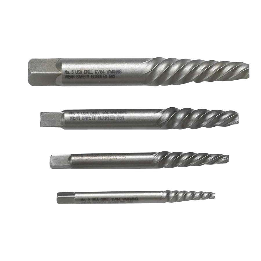

I had this happen to my GF’s shoes last year and it was a pain to remove the screws. What worked was to drill a hole on the bolt and then use a screw extractor that I bought at Sears:
http://www.sears.com/sr/javasr/product.do?cat=Hand+Tools%2C+General+Purpose&pid=00999067000&vertical=TOOL&subcat=Bolt-Out%2C+Taps+%26+Dies&BV_UseBVCookie=Yes
http://s7.sears.com/is/image/Sears/00999067000
Actually I had to buy 3 extractors, as I broke 2 of them in the process. So, be patient…
