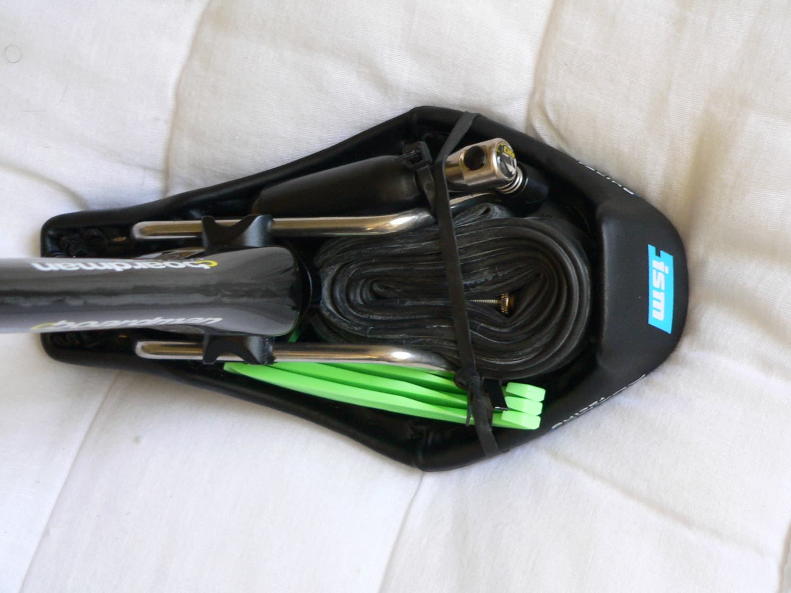

You could wrap a light, TPU tube around the rear hub (minimal rotational inertia issues; still the access issues); but why not just put some supplies in a ziploc and tape it under your saddle (among many storage options)?
