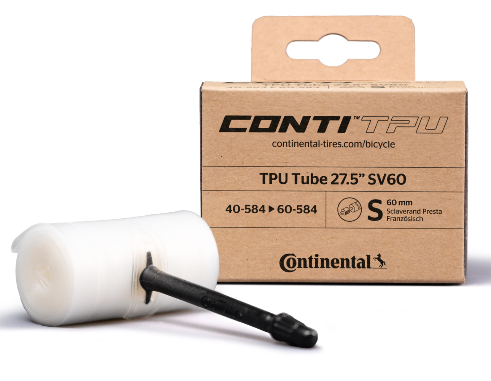

Looks like they did. ContiTPU Tubes

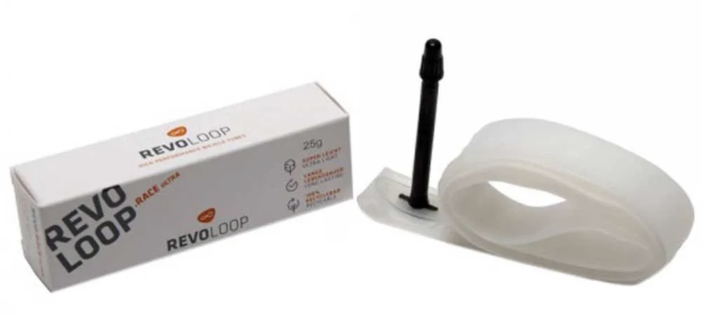

Looks like Conti just rebranded / reboxed the Revoloop tubes.
They look exactly the same. Same weak spot around the plastic valve stem.

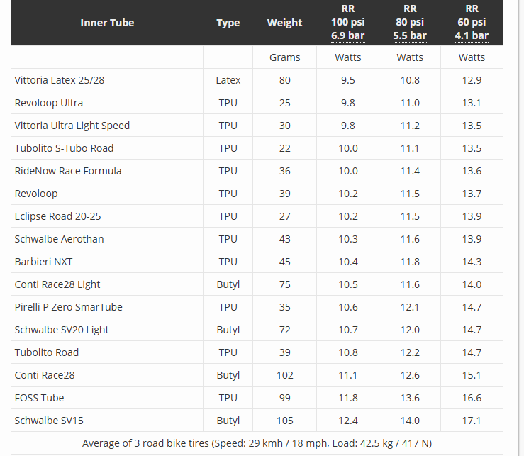

The thing with TPU tubes is that, depending on design, they can roll almost as well as latex or as poorly as butyl. Look at the Tublito regular vs. their S-Turbo (chart below).Some brands (ex. RideNow) have also had issues with bad batches that had slow, undetectable leaks. Personally, I love the idea of TPU tubes (and have Tublitos in my race flat kit for weight/compactness); but am sticking with latex for the moment.
Revoloop doesn’t have any week spots there. I used them for years and not a single one lelked. Meanwhile the Vittorias that I had previously would development leaks in that area over time after they switched to the smaller patch design.
