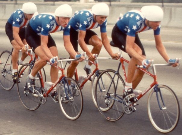

Would running a “funny car” staggered tire setup provide a tangible aero benefit from your “stack height” as viewed from the road surface?
http://classiccycleus.com/home/wp-content/uploads/2018/11/E8BD28DD-D1A8-41E1-8780-338BFD241BDF.jpeg
