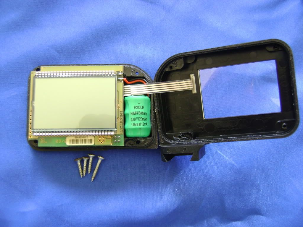

Not sure about supply of PC V/VI batteries in Canada, but they are NOT standard batteries. See attached photo.
http://i1205.photobucket.com/albums/bb432/MarkGeoghegan/DSC04096.jpg
I purchased my replacement battery from a guy in Australia, then shipped them to Hawaii (regular mail), then replaced the battery myself. I have lots of photos and step-by-step instructions is you want them.

Hi Dev,
Some very basic soldering is required.
Not sure of the 14 hr vs 32 hr, but I know the guy in Oz made up a bunch to conform to the original SRM PC V and VI specs. The price was US$10 each battery, plus US$10 flat rate for air mail. When I get home I will dig up the info and get it to you.
I have full photos with description of step-by-step procedure to replace PC and PM batteries…and calibration too. Give me your email and I will get this stuff to you.

I replaced my PCV battery recently. If you’re (or someone you know) comfortable with soldering, it’s a very simple 15min job.
There is a seller in the UK that sells the 3NH-100H Replacement Battery for the PCV. It’s 110mAh that matches the OEM one.
Another option is to use three serial-connected 1/4AAA batteries. They are 80mAh rechargeable NiMH 1.2V each. I taped them up and soldered them with small pieces of wires. Took me 30min. These are widely available and costs $3 each. The reduced capacity isn’t a concern to me, they last 12hrs and I recharge after each ride.

I replaced one this weekend. You can get 3.6V 80 mAh NiMh batteries on amazon for $5-10 shipped. Just unscrew the back panel, unsolder the old one, and solder in the replacement.
