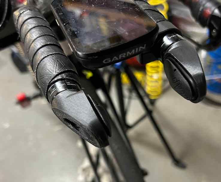

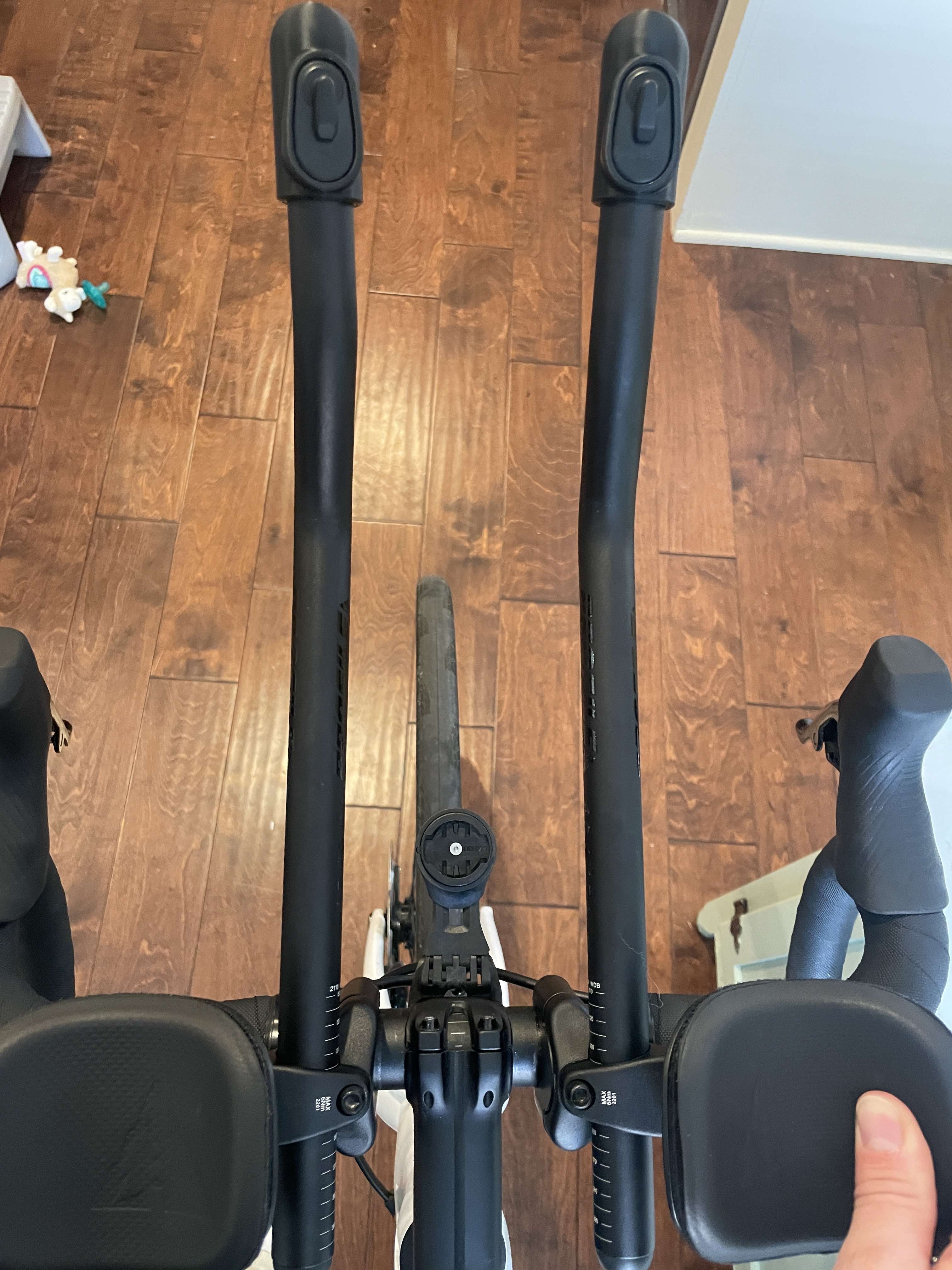

I digress here are my pics on the ones I liked on my aero bars… I’m toying with where I want them in terms of button placement and I need to put on new tape since my new ones are essentially plugs vs. the previous ones I was using that covered the end of the bar. Also have the aftermarket buttons installed on them that I really like as well.

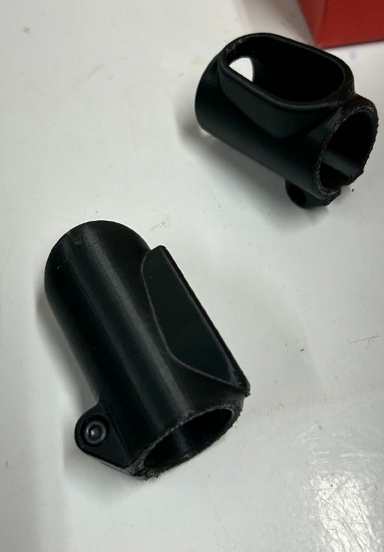

Now the ones I printed and don’t like… they’re kind of bulky for me. I may try cutting the ones for my base bar in half and blending them into the bar and taping over them but to be determined…
