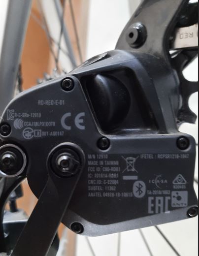

Only problem is I don’t know if I got one or not.
I have taken picture of mine in attachement
If it came stock with the 10-26 cassette it’s probably not compatible with the 10-36. The only way I know to tell the RED AXS rear derailleurs apart is with a label next to the mounting bolt. Unbolt the rear derailleur and look for this.

I found a place to enter the serial number of my cage. There it says it has 33T. So I gonna go for 10-33.
