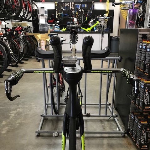

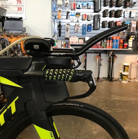

I’ve got the blip box right between the tips of the aero bars. No clics, wires, or blips anywhere, just the box. Really don’t need any shifters/buttons elsewhere on the base bar.

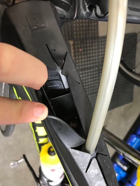

There’s an incredibly detailed Scott build manual put together by “NoPain.” The image below was included in their build and I’ve marked the route I took my wire. The bike was designed to integrate Di2 really cleanly, so this wasn’t too much of a stretch. The path I used is marked in green, and the areas I marked in magenta are where I plan to cut the wire are add a plug/jack connection. I’m only doing that because I travel to races a bit and I take my seat off when I do.
One nice thing about this bike (and probably most other TT frames?) is that once you get through the bars and into the frame, there’s loads of space. I could have easily placed the blipbox into the frame. I tested it and had no issues with the wireless transmission, but I set this up so that I wouldn’t have to disassemble my bike when my blipbox battery undoubtedly dies on race day. But, it’s definitely an option.

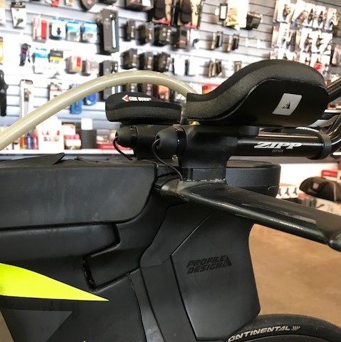

For the splice, the shifter wires are just about the thinnest wires I’ve ever worked with. Stripping those wires was the unnerving part for me, but I bet someone with more experience or better tools would breeze right through it. For the wire, I just decided to use insulated speaker wire. No reason other than that’s what I had around the house and I could make it any length I wanted. For the connections, I soldered everything. Probably not necessary, but it’s pretty inaccessible once it runs through the frame, so I wanted to be safe. I also used heat-shrink tubing with an adhesive lining on the inside for each individual wire and then a third to contain them both (again, probably overkill).
The last decision I went with was that I used the direct mount screw to attach the blipbox to the gopro saddle mount. There are many options to get a Garmin quarter-turn mount on your saddle or seat. This just did what I was looking for. It got it out of the way of my saddle bag, and I felt more comfortable with the bolt, since I probably wouldn’t notice if it popped off a garmin mount and was just hanging by its wires.
