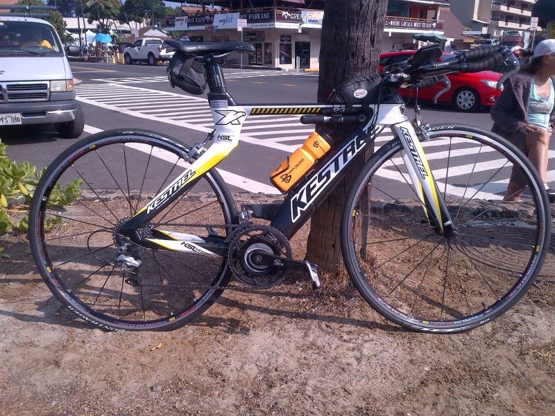

Regular cassette swap, and B screw in all the way, short cage Ultegra 10 speed rear derailleur and the top pulley wheel barely clears the 32, but it does (by around 1 mm). Also needed to set the “set screws” for my rear drop out so that I could slam the axle in all the way, creating a touch more clearance from the 32 tooth.
Here is the set up with 50/34 compact and 11-32 rear. I can only use in big to “second biggest”. I already had a slightly longer chain (2 links) to accomodate a 28 tooth. When riding in the small ring I can go from small to 3rd smallest, but not down to the 12 and 11 tooth…there is no need to ride in 32x12 and 34x11 anyway. That same gear is the same as a 50x17 and a 50x16
http://i96.photobucket.com/albums/l195/devashish_paul/NorthKona-20121009-00053.jpg
http://i96.photobucket.com/albums/l195/devashish_paul/NorthKona-20121009-00055.jpg
The reason I got this gearing was to ride up Kaloko and Mauna Kea access road. Both of which have extended sections at 15-20% grade. In the case of Mauna Kea access road, it is between 6000 and 9300 feet, so we needed all the gearing possible.
