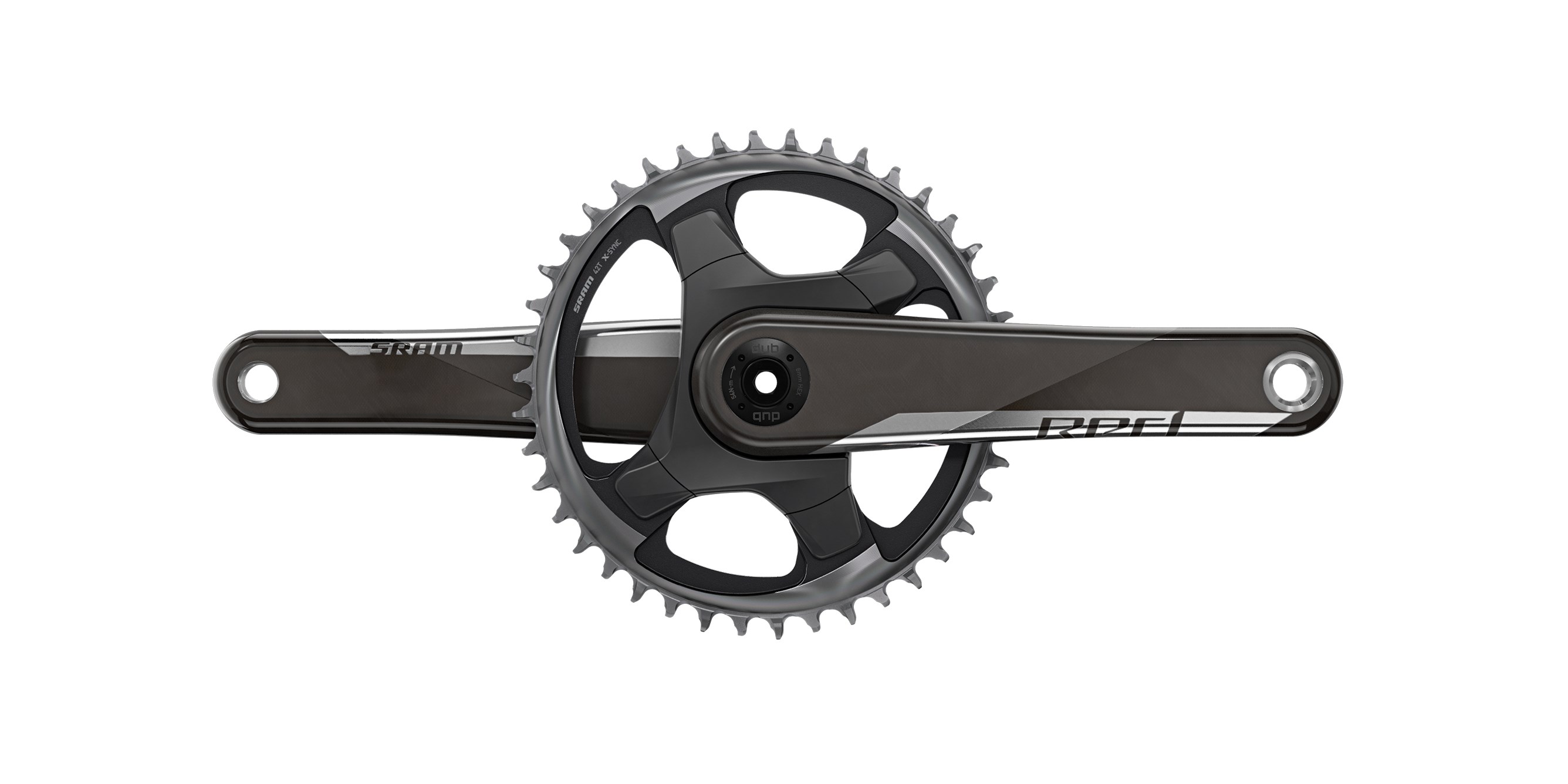

Hi, I currently have a r8000 11 speed shimano ultegra di2 on my bike. I’m interested in getting a SRAM red axs 1x aero chainring for its integrated power meter and possibly for a future 12 speed upgrade.
Anybody know will this chainring work with a 11 speed cassette and rear derailleur? If yes, what chain to use, shimano chain? 3rd party chain?

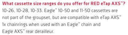

I just did some research on this, and it might actually work. Sram says 1x AXS chainring is compatible with Eagle chain. Eagle chain is sram’s mtb 12 speed chain and many folks has confirmed it’s compatible with the 11 speed sram/shimano mtb/road system. I would avoid the new 12 speed red flat top chain since the flat top might not work with the rear derailleur upper pulley.

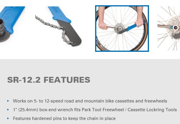

Also park tool has this new chain whip that work with 5 speed to 12 speed. 12 speed chain just has thinner side wall, since the chainring will only see the inside part of the chain, this should not make a difference.
