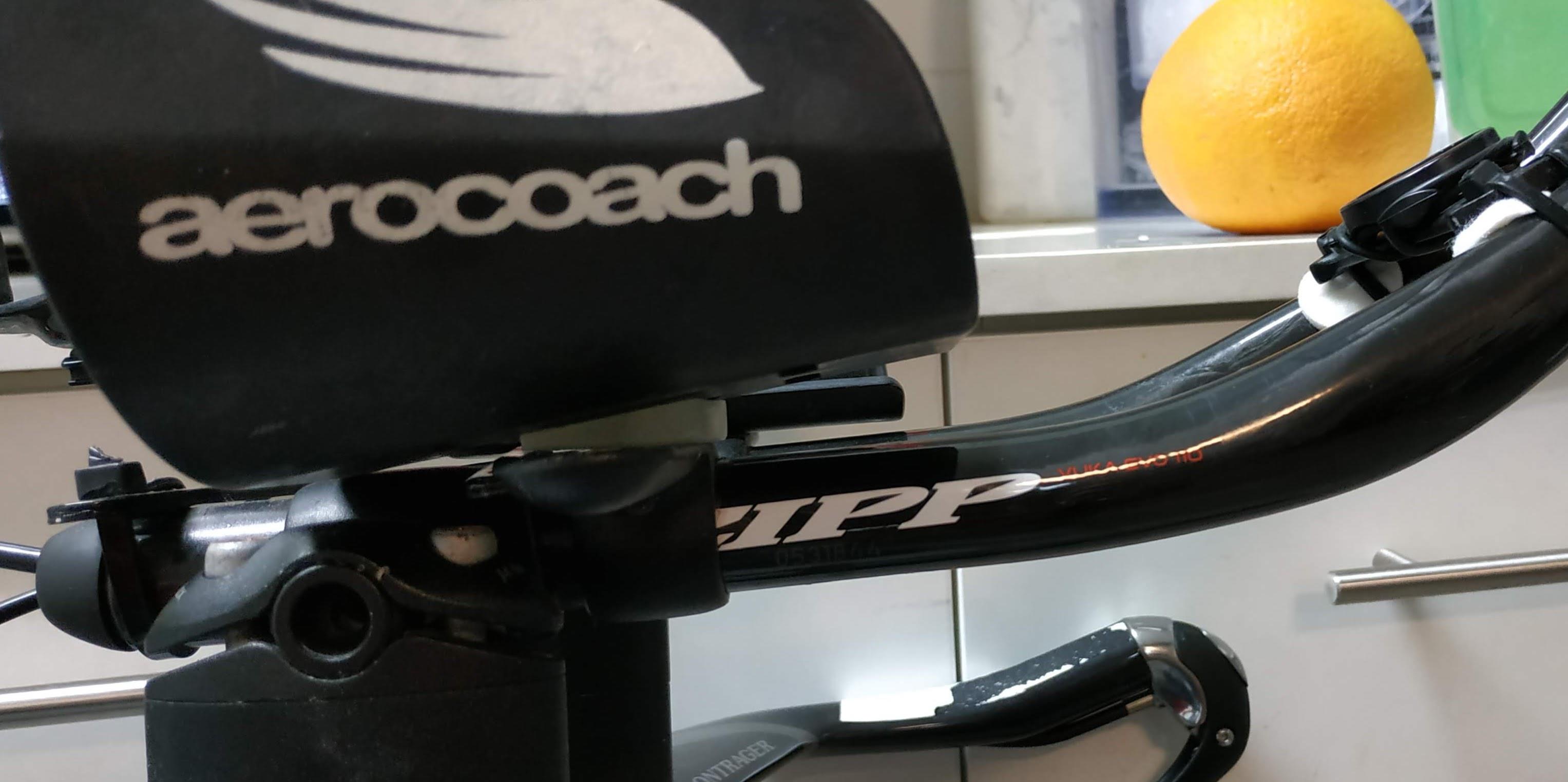

Yeah, I 3D-printed a pair of 10 deg wedges for my Speed Concept for practically nothing - such a small print that I just piggy-backed on a bigger print, the added material was negligible. A washer and countersunk bolt was all that was needed.
Can you post a picture of your aerobar and pad setup with the 3d printed wedges?
It’s the only picture I have, sorry. First-gen SC, stock bracket ahead of the extension mount, Zipp Vuka Evo 110 extensions, Aerocoach Align Wing arm rests with 10mm pad (stock).
I tried the 70s+tilt but it wasn’t as comfortable as the 110 with wedges, plus this way I get to keep my BTA level.
Awesome. Thanks!
