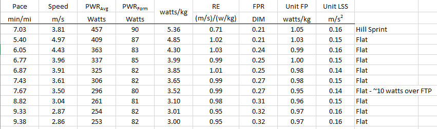

To compare to other runners, you really need to compare w/kg as raw watts is pretty meaningless for Stryd. The pod reports w/kg and just multiplies that with your weight setting to arrive at a total watts value.
To that end, what is your Stryd weight setting? Based on the numbers you posted, something seems off. Your running effectiveness is super high, and maybe it’s right, but according to WKO your RE is in the realm of elite athletes.
And for comparison sake, here’s some of my data. I’m about 188lbs and slow.
