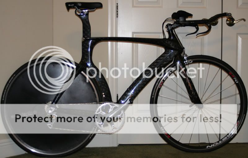

I believe it is this frame… http://i1040.photobucket.com/albums/b404/EvenOlder/Whole.jpg
That frame is a relatively well known TT frame (FM-018) and I haven’t heard any specific complaints about durability.

As far as jackmott’s comments. I have no idea if it’s a ‘terrible’ aerodynamic frame, but I think we can all agree that the specialized transition is a tough frame to beat. I would doubt that the FM-018 is as good as a frame that was designed / tweaked in the tunnel.
