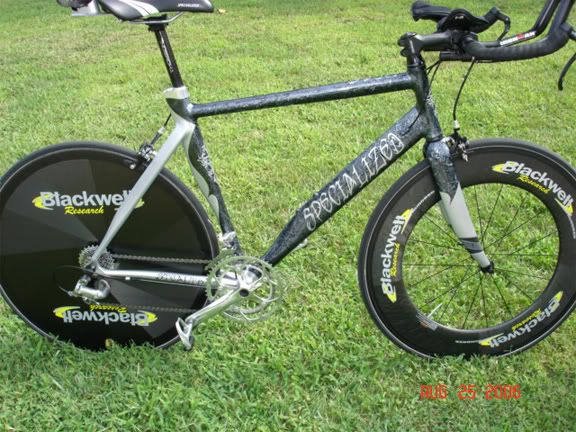

i have one and love it…but mine came with a thompson seat post
http://i85.photobucket.com/albums/k44/cdrucks/chad_stealth.jpg
