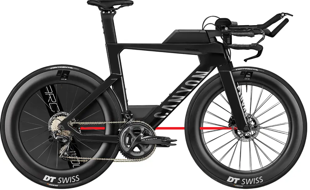

imo canyon not so different from shiv

Canyon has two tt frames. The one with the first photo is the short and tall, the one on the latter overlay photo appears to be the long and low version. These two frame geometries are on quite opposite ends of the short/long - high/low spectrum what comes to tt bike geometries in general.

Well, sure they look similar to some extent, in the end of the day, they all are tt bikes. But honestly, you can not compare geometries of different bikes just by looking at photos; for that reason there are geometry charts. For simplicity, you can look at stack and reach measurements to compare how low/high and short/long the bikes are.
The speedmax CFR has 489 mm stack and 438 mm reach (size medium).
The speedmax CF has 544 mm stack and 420 mm reach (size medium).
To put e.g. the differences in stack heights in context, typically the difference between to sizes is roughly 20 mm. These two frames (both in size M) have a difference of 55 mm.
Another way to put the stack/reach measurements in context, the Canyon endurace roadbike has 590 mm stack and 387 mm reach.

speedmax cf basebar really looks much higher than cfr.

on photos from Aug 7, 24 10:56 they use speedmax cf wmn, that’s why basebar heigh is look like road bike …
