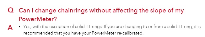

Then explain this from SRM:
Link: http://www.srm.de/support/faq/powermeter/
Your original post was about crank based powermeters, the link you posted to was for a spider based powermeter.

So it’s correct to assume that a stiffer ring would lead to a higher and not lower power reading for a spider based power meter? My gut and common sense tell me that this is the case, but I’m not 100% sure.
My hunch is the opposite. The spider meter measures the strain in the spider. If it is firmly attached to a rigid body, then there is a larger body to to participate in the distribution of the force and stain. Therefore the PM would detect lower strain.

It is safe to assume that changing chainrings can effect the readings of a spider based power meter, and one should definitely recalibrate (if possible) when doing so.

It’s a best practice. The reason srm notes is partially bc they offer service that includes calibration and partially since anyone who buys a 3k power meter probably also cares about having it in top condition.
On my old 7900 srm swapping from a solid fsa ring to a 7900 ring changed the slope a couple percent.
